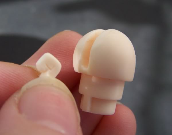

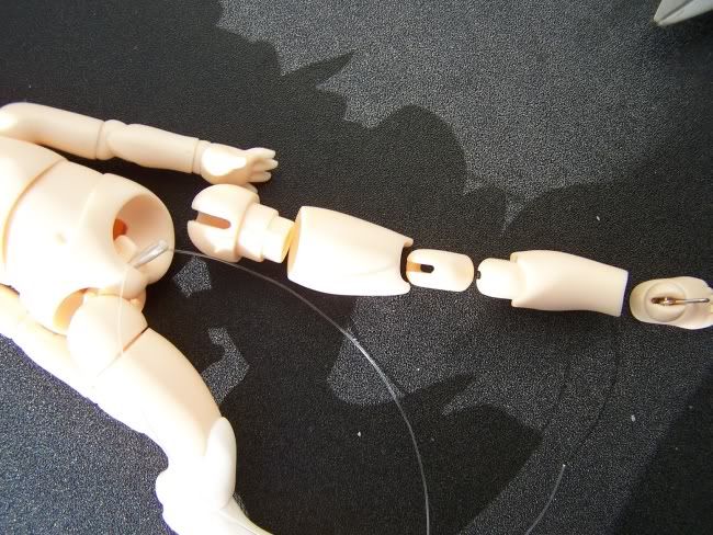

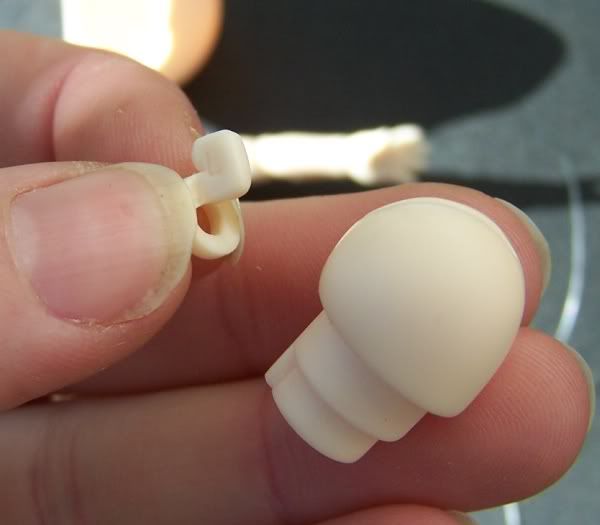

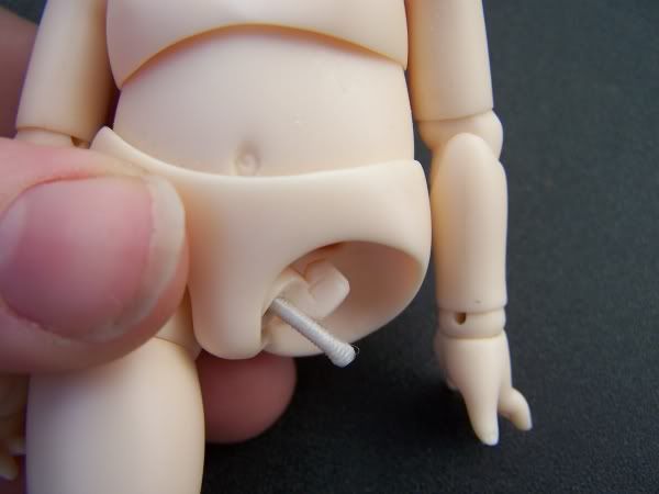

    3. all the bits laid out, Fairyland was nice, and marked everything L or R, we're working on the Left leg

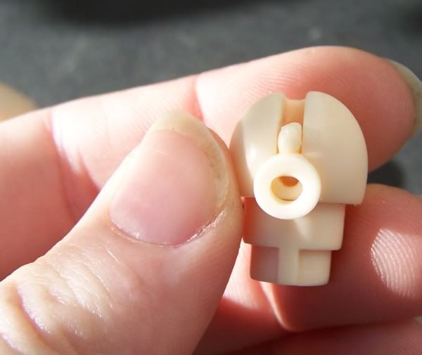

      the teeny tiny hip piece was a little confusing for me, so I've shown how it fits into the large hip piece with these three pictures

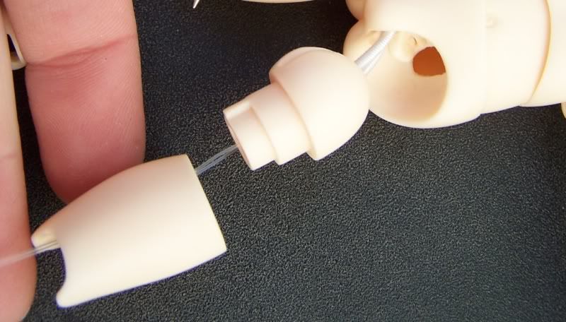

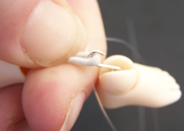

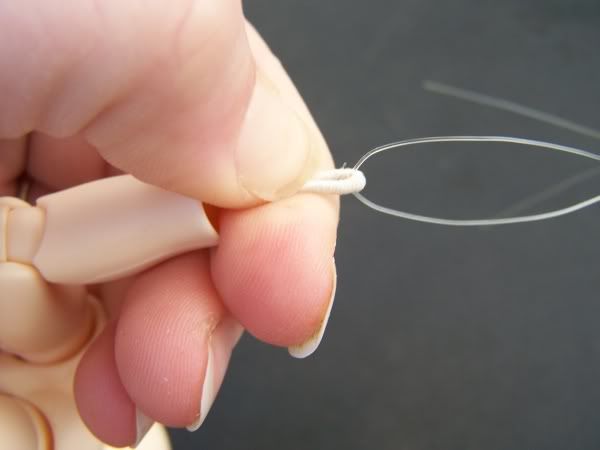

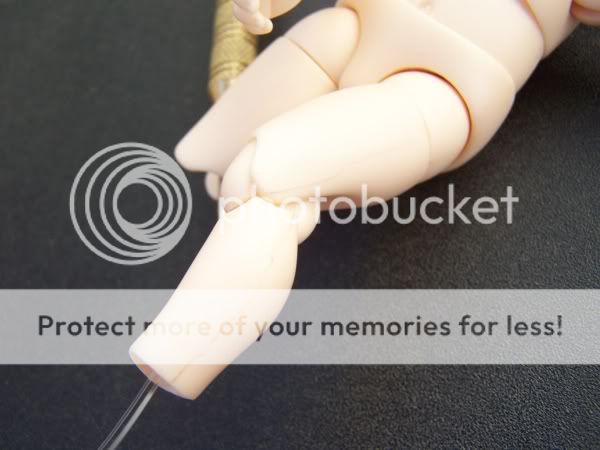

      I use a bit of fishing line to thread all the parts

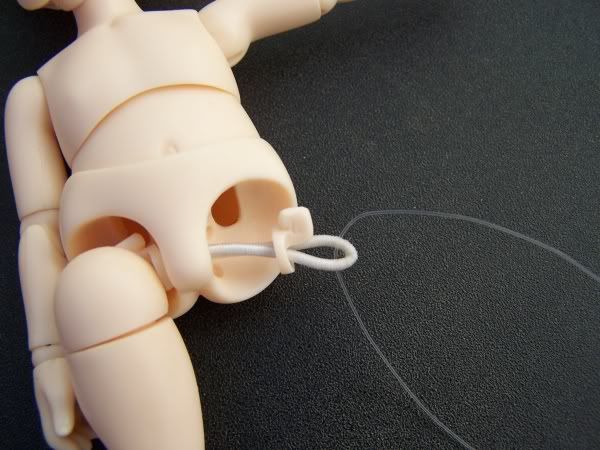

      here's the tough part! PukiFee's were strung by Superman himself, and they are TIGHT Waverly has been worked around a bit until she was a little looser, so you'll have to pull a heck of a lot harder than it looks like I am pulling, get help! have someone hang on to the fishing line while you hang onto the leg and the foot/hook, as soon as you see that elastic end, HOOK THE FOOT OMG!
      whew!

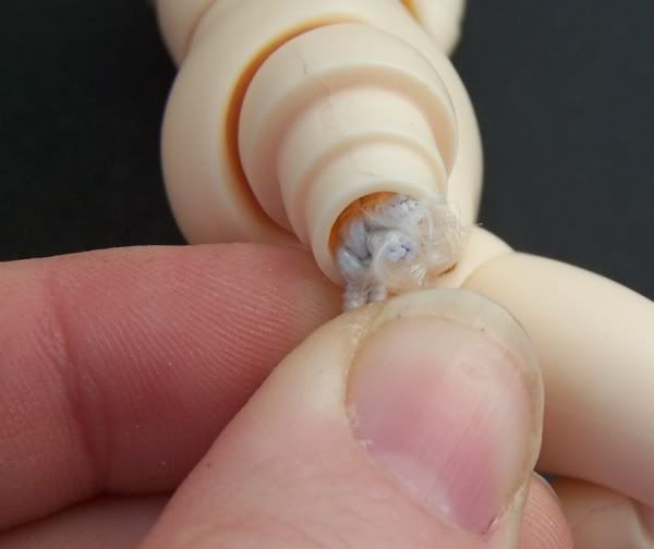

      Also, you need to make sure your leg's knot is hidden up inside either of the top two larger joints, the knot cannot fit through the knee piece, or the tiny hip piece (as shown on Waverly's Right leg)
    4. not to be a posty-pants, but does anyone know what the large holes are supposed to be for, in her hips?
      the holes that lead up into her tummy piece? maybe if we wanted to string them in the "traditional" way? from head to foot or something?

      Okay, how did you unhook that wee hook? I think my tension is way way way too tight and I'm worried about either snapping the elastic or stretching it out of its stretchiness.
    6. the first time I un-hooked her feet was nerve wrecking! seriously the tightest doll I have ever had!
      I ended up threading another bit of elastic through what precious little of her elastic that I could reach, and then yanked on that until I could push her S-hook loose from it
      might help if you bend her other leg so you get as much possible slack as you can
