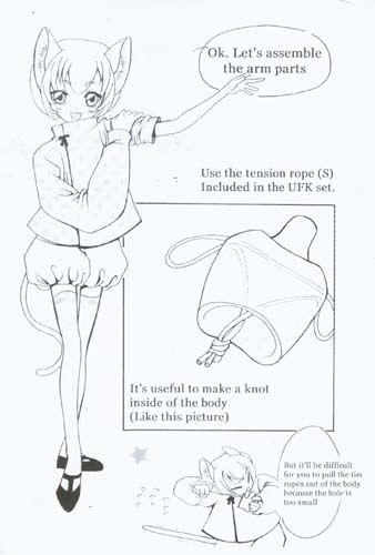

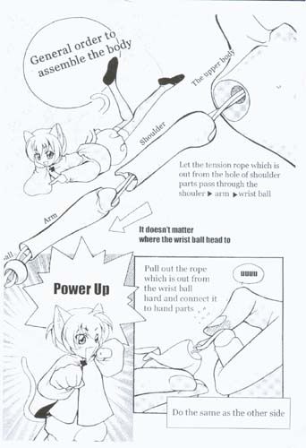

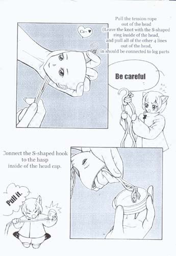

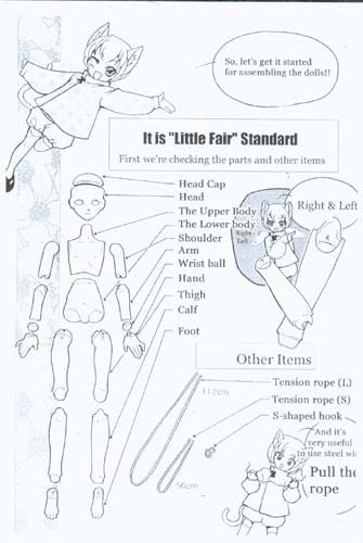

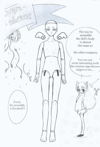

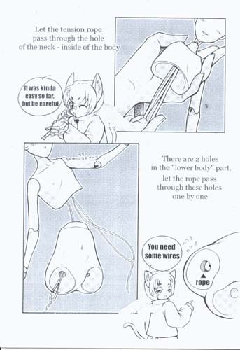

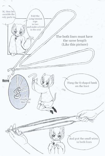

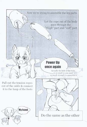

    1. this is for the people who didnt request to have an instruction booklet included with their UFK order from AngelRegion. I just got mine today so I scanned most of the booklet

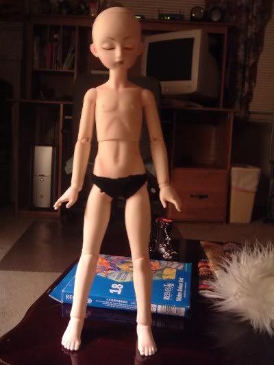

      There is also an extra peice to the lower torso that snaps in place so no glue is required...atleast i didnt need it ^^;
      p.s. please dont directly link to my images :roll:
      Ta da
      enjoy![/img]
    2. It snapped in place for you?! Dude, then what happened with my Ami and Dana...I swear I tried everything before reaching for the glue gun.
    3. well i dunno could it of been that the boy bodies are different? it just went right in and made a snap sound... i even tested it to see if it would come out and it didnt :oops:
    4. is the S-hook n tension cord included with the UFK?
    5. yep ^^
    6. How very interesting. I guess they've changed the bodies since the last preorder. Oh, now I really wish I'd ordered this time around.
    7. Yup, they're included.
    8. someone else had the same problem because i remember her posting it and she ordered this time around for the ufk...but she also had a girl body so i dunno it might be the that =/
    9. That tutorial is really cute and easy to follow. Is it the same to restring other dolls too?

    10. i think the AR fair dolls might have extra thigh pieces, similar to the torso piece.
      it is basically the same to string any doll, but most companies have their own instructions, which could be more useful.
    11. Looking at my Elly UFK compared to the LF instructions, it seems to be mostly the same. Just the extra thigh pieces that probably need to be glued.
      Obviously you have to get a little creative and do some trial and error with the lengths for the string for the Fairs, though. ^^; But it's not hard. Got it too short the first time, then got it too long, then just eyeballed what it SHOULD be and did it that way. X3;;; Worked like a charm. ^^

    18. hee hee. i like the instructions. i like how they put power up when they had to pull the strings!!! and later how it said "my hands!!"
