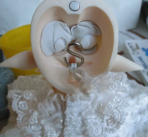

    5. It is a little tricky to change the bodies out, but it can be done. I don't know if ALL Bambicrony heads are made the same way, but my Kumi has a magnetic head cap. You pop that off and inside the head there is an S-hook. Make the S hook go through the space at the bottom of her head.
      To put a head back on, it helps to use wire to pull the strings through the bottom of the head, and then attach the S hook.

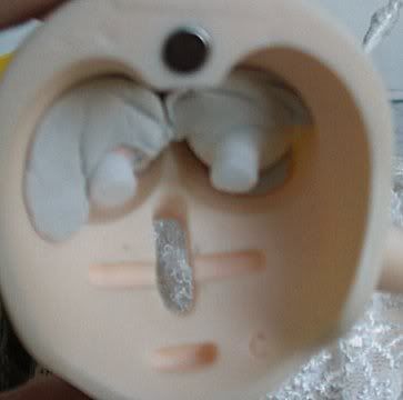

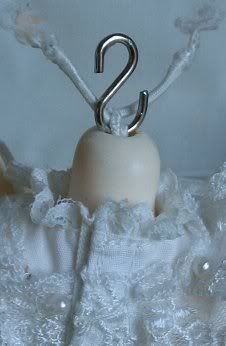

    6. NyuNyu's dirrections are perfect, but I took some pictures too incase it you haven't got a doll yet to have seen inside their head.
      Tilt headcap back and lift up (it has a little lip on the back)
      The S hook is sitting in a horizontal indentation - lift up and turn lowering gently into vertical slot l.
      Lift off body
      (I took a picture so you can see slot/indent without the hook)
      Place other head on body, hook through vertical slot, lift and turn hook to sit back into the horizontal indentation to secure head in place.
