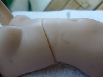

      -softness of resin, even clothes can cause indents on the body

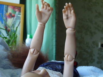

      I wrote on D-storic's q&a board and I'm hoping they'll be able to help. :( I wouldn't have thought to check if I didn't hear about other people's doll warping. T_T When I noticed she wasn't standing up and when I took a closer look, there it was...WARPED right leg and wrists. :(

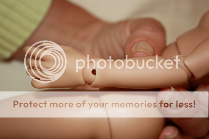

    4. I see that my order has already been marked bold. I would like to add that I'm 95% sure that my doll's left wrist has warped. It looks like the other wrists posted here. I think her wrist looked normal and slimmer when my girl arrived in Feb. :( I hope she won't warp even more in the future. I can handle the wrist looking bulgy, but those legs... *cringes*
    5. I'm glad your head is OK. I read that someone's head gave a smell and touching it gave a burning sensation. Other signs are softness of the resin, dents appear easily. I saw black stains as well, not sure if that was part of it.

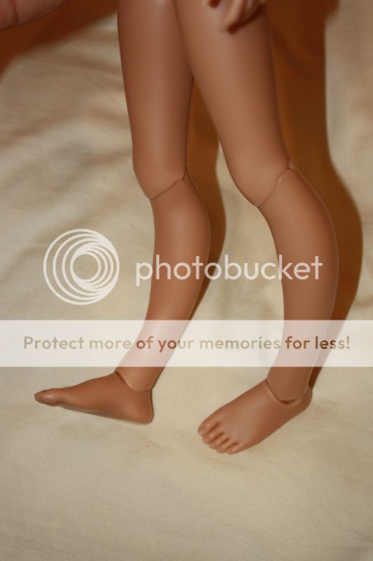

    11. I'm pretty darn sure she's warping at this point... It's mostly in her ankles, because they're REALLY different at this point, and I think in her wrists a little. She can still stand, but I don't want her to CONTINUE warping!
