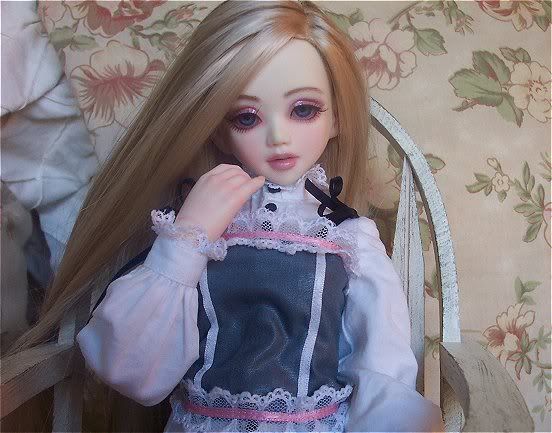

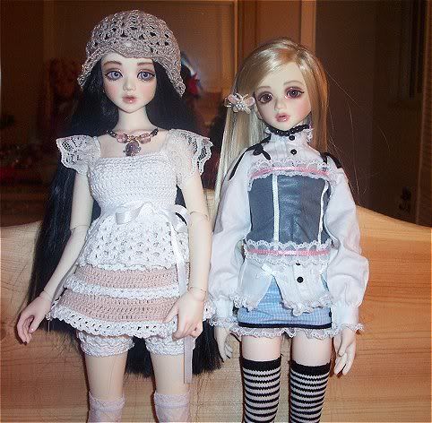

    7. My girls together. This pic is horrible..but it's the best I can do without Natural light. I love her very much. :)
      THANK YOU so much to everyone who gave help and instruction on putting this doll together. The tips in this thread helped alot.
      ~Meee

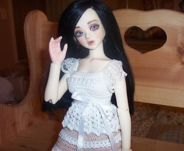

    8. Abby....since the joints "Click" into place...I think it's be okay. I used the Super Glue (Gel) Because I just didn't want to take any chances.
      I redid my girls faceup and she stole the wig and outfit from my Hybrid. I like her with her new faceup much more :)
      I hope everyone's having fun putting their kits together. ;)
      ~Meee

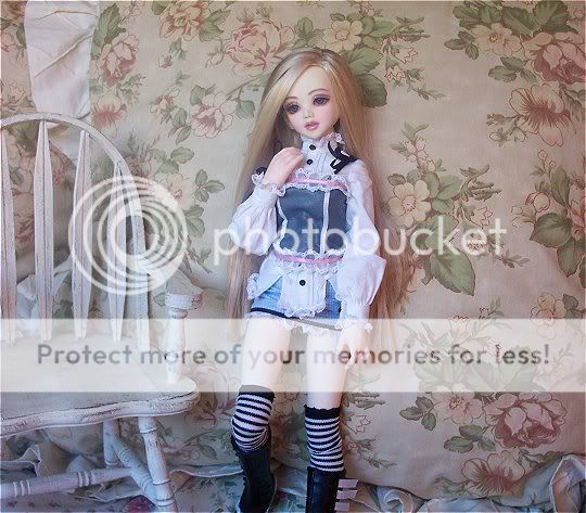

    9. Everyones Girls Look Great! Its exciting to see all of them & have so many Arriving.
      Here is Mine (No Name yet)-The face up is not by me. Its a Wink Face plate I got this summer.
      It was fun to put her together. Easier then I thought it would be. Getting her feet on was hard!
      dress & wig by me

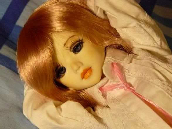

    12. I got my girl yesterday, is an Unoa Lusis with big breast part and today I have finished the assembling and the face-up. This is the first time I do it by myself. Hope you like it. ;)
