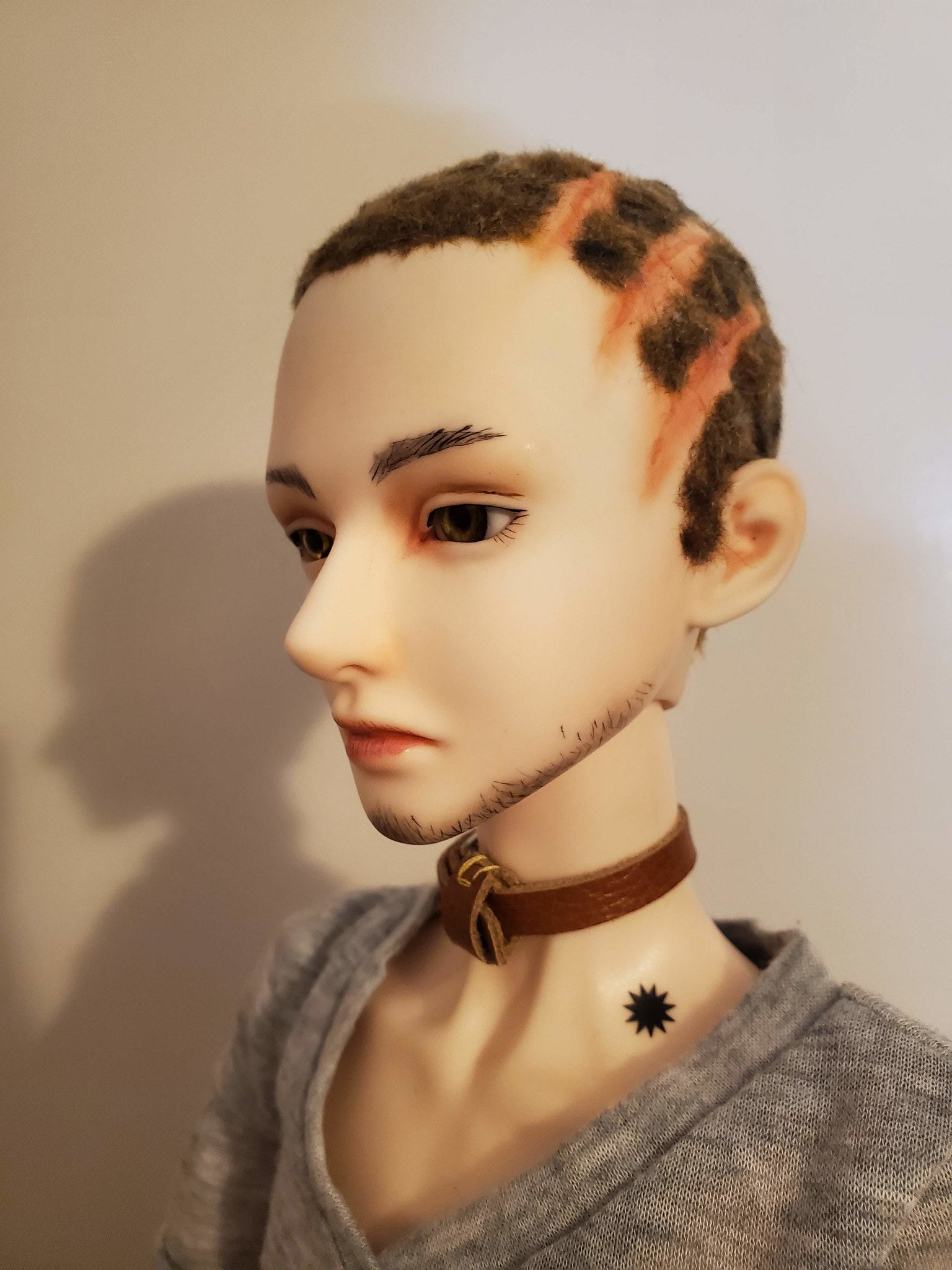

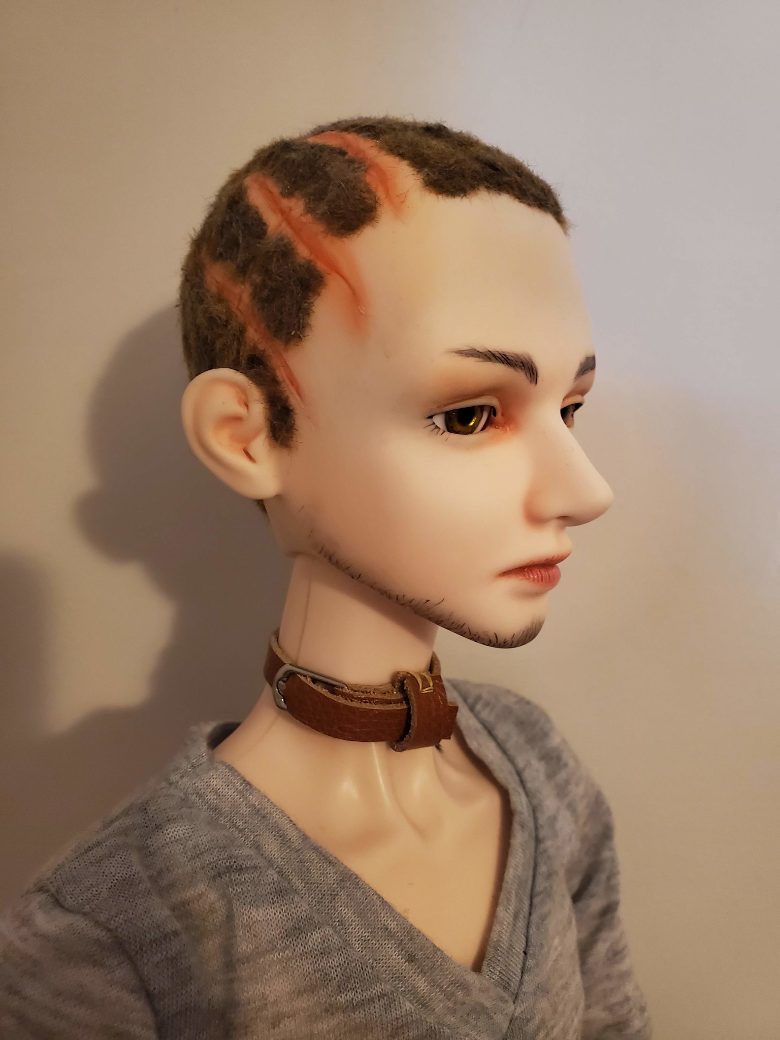

    11. I no longer have this girl, as a friend owns her now, but I have some old pics of the flocking I did. It's just super short craft flocking (I think this one was actually meant to be dirt for model trains...) glued directly to her head. Headcaps felt too bulky to me. I painted her head first, then coated it with Aleene's Tacky glue, sprinkled on the flocking, dusting it a bit with a makeup brush to get it even, let it dry, then repeat the flocking part. The seam for the headcap does show a little bit, but I didn't mind that as much as I would have a headcap. (Note: this really only works with dolls with no headplate and flush headcaps.) I did remover her head for dressing so nothing was rubbing against the flocking, though it is pretty strong and normal touching didn't damage it.

    12. She's absolutely gorgeous! However, the hair texture created with that may not work for my guy. I think flocking looks best for curlier hair texturing! Do you think this texturing would look good/work on a 'white' doll?
