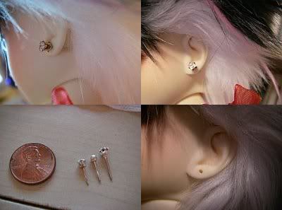

    7. I have a B&G girl with her ears peirced. I used a needle though. Currently, she is wearing baby earings(I had them when I was a little girl?).
      As you can see, only the smallest earing there will fit.​
