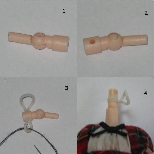

    14. Well, I modified the neck thingy for the elfdoll head, and took pictures! Photos 1, 2 and 3 show the modified neck pc. I outlined in photo 1 how the neck piece is two pieces snapped together at the ball joint. I hope you can understand that. It's hard to see in a photo, but there are two halves to the sphere and they snap together so that the top can bend down, forming an L if it wants to. I drilled a hole in the piece that would normally be stuffed into a vinyl head, and held there via the flaring out shape. I then drew a small silicon band, the kind that came from my daughter's bracelet making loom that are popular right now. I think these bands are also the same kind that you can get for your hair, about 1/2" to 3/4" long. Just take the two loops after drawing them through the neck pc. and hook them into the head cap hook and you're finished :)
      The last picture shows what I tried before drilling a hole. I simply wrapped the band around the small end above the ball joint, tightened it, so that the bulk of the band was as small as possible, then shoved the band through the neck hole, grabbed it and shoved the end pc.through the head, lining up the bulk with one of the slits. This would have worked quite well (after pressing the head well on to the neck) except my band ended up too long and there was not enough tension to hold the head cap in place. I would need smaller bands for this to work :).
      Hope this helps anyone fitting an Elfdoll head on a Picco Neemo body! I think it looks great and I'll get back with some fashion pictures :D
      Edit: Now that I have my dolls put together, I wish I had slightly smaller bands, so try something smaller if you can for more tension :)

      Just throwing a few ideas out there: Wonder if a home made S hook would work to hold the head cap in place if you threaded it through your drilled hole? Maybe make your own loop with elastic thread so that you could get it smaller and have more tension? I have no time until maybe next month to play and focus on my girls. I did want to try and open up Kai's eyes a bit before I tried a faceup on her.

    16. Oh wow, that's cool! I think my bodies may be the same size as the big one. They end up being half a head taller than regular Elfdolls. I don't mind though. It's nice to have an option. I love their clothes, but so much of it is sold out on the Japanise websites. And if you go to ebay everything costs 2X as much! This has really been great because my daughter didn't get much for her birthday (just some clothes from grandparents and chocolate from us) So I used my birthday money from my mom (a month later) to buy these dolls. It's a little late, but at least now I can give her something nice :D I painted them last night and now I have to take pcitures for her. BTW, I'm not the best faceup artist, lol, especially on tinies, but did my best. Will try taking a photo a little later :) I can't wait to give this to her when she gets back from visiting grandparents at the end of the month! So excited!
      Also, yes, stringing a shorter pc. of chord (tiny chord) would be a great option. I actually have some I found at JoAnn's and might give that a try.
