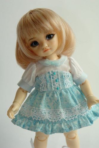

    16. Have not visited the forum. Greetings from Beneris. She had a new dress)
      DSC06158 by YaskoGalina, on Flickr

    18. She's gorgeous...I love the blonde wig...it's perfect on her.:)
