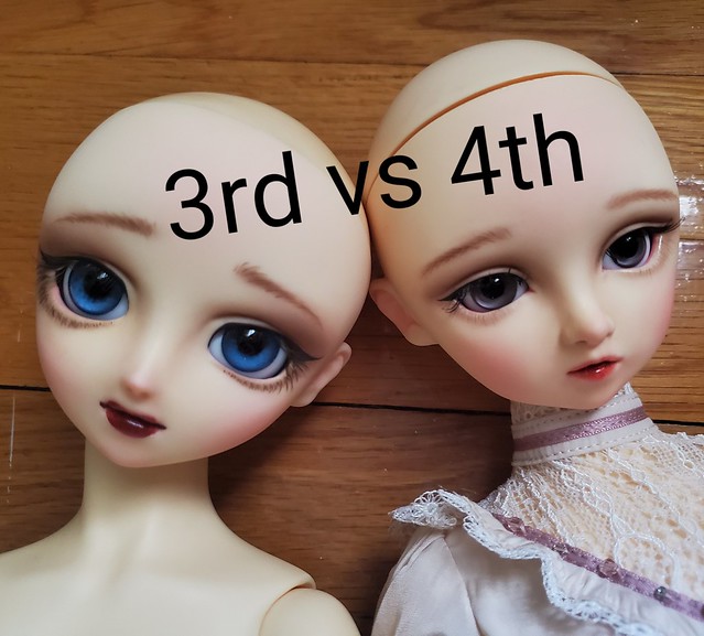

      With each faceup I do, I can see improvement in myself. If you're able to, I would encourage you to take lots of photos of your work, and even put it side by side when you can. You can see yourself grow and easily identify the next areas that you want to improve in!
      For example, the one on the left here was my 3rd attempt at a faceup, where I had used paint to do the brow hairs and eyelashes for the first time. When I completed it, I was so proud of myself, because it turned out better than I expected. Comically, I finished my 4th attempt and was absolutely blown away when I put them side by side. When I look at the 3rd attempt now, I chuckle at the thought that I was ever pleased with it. But that's not a bad thing; it's good to celebrate every time you have accomplished a new skill! I'm sure I'll feel the same way when I look at the 5th compared to the 4th, and so on and so on.
      Even in one iteration, I saw a huge improvement.
      Don't be discouraged, and keep at it!
