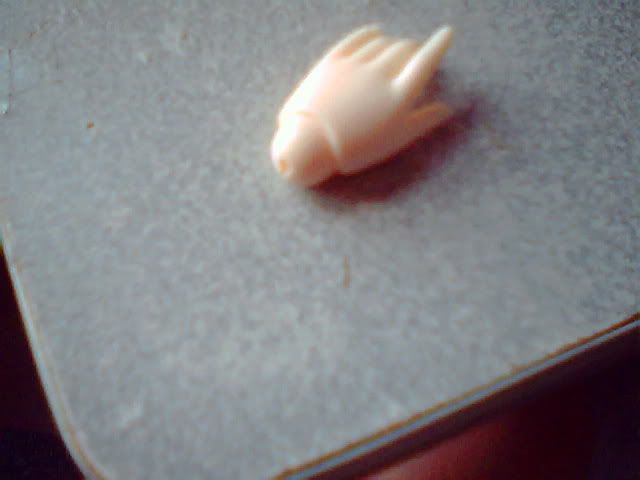

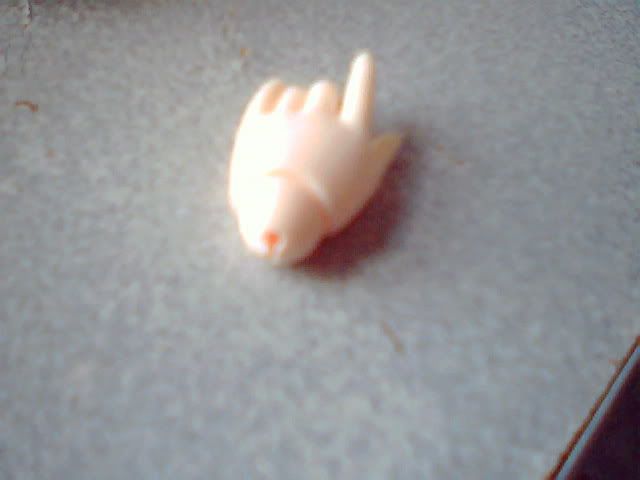

      Megan's hand just popped off! All I did was move her arm a bit and SNAP! The hook just broke right off and is stuck inside her arm!!!!!! I looked at her hand and it didn't even look as if the hook was molded in properly! It looks horribly done!
      I tried to take some pictures but none of them will come out good! Here's ones I took:
      I don't know much about the whole insides of BJDs but I don't see any way at all that I can put her hand back on! It literally broke off! And with such horrible pictures, I don't know what to do! This is tragic.
      This whole is experience is heartbreaking!!! What should I do?? I was just starting to like her and then this happens!! :(
      I'm in tears.....I don't know what to do....her poor little hand....what should I do....what should I do....

    10. Look at her other hand and tell us what the difference is.
      Your pictures are too blurry/grainy to see what's wrong. It looks like the hand has a hole in the wrist end with a slot that goes all the way through to the outside of the wrist. Is that correct?

    17. Thanks guys. My camera pretty much only has three functions; On, off, and shoot. XD;; It's a horrible horrible camera, but the only one I've got... But I've been looking at her and and this is what it looks like:
      On the ball of her hand there's a shape that kinda looks like this: o-o
      Inside her arm it looks like a little metal loop that's stuck in there. Where the two "o"'s are in the shape, it looks as though the hook was looped through that. But the "-" in the shape as actually broken in half and so it's just a long hole there. I mean, there's literally a bad, uneven break where it seems that the hook was held in.
      Does that sound right? My boyfriend suggested I take a hanger and try to pull the hook from her arm to see exactly what happened (she's so small, it's hard to tell). Is there any possible way to do this without unstringing her? My stomach gets sick when I think about it....:(
