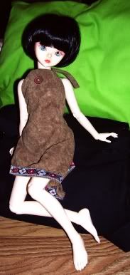

    2. If you look in this thread, you can see pictures of Ivy (Ttory head/MNF body). I also have a gallery of images here (some are nude photos that show the head/body combination well).
      No modification is needed to put a KD head on a Mini-Fee body, and I'm quite pleased with Ivy's poseability/proportions/etc., she's one of my favorite dolls ^-^

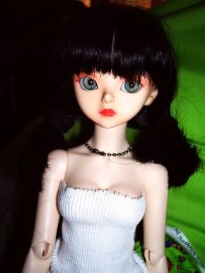

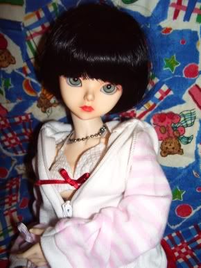

    14. My Ani, QiXa, works wonderfully with the MNF body! Actually- I don't think she looks like her head is too big for her body- the neck hole fits the MNF neck really well and you really can't tell they were not originally the same doll. You WILL have to take the neck mechanism off the MNF body and because the 'S' hook is so small for the MNF body, you will have to use a larger 'S' hook to connect the head and body. As for the neck breaking- the MNF neck is made very strong and works very good with the Ani head-and the MNF body is close to Kid Delf in size- it just has smaller scale hands, waist and legs, but isn't that much smaller over all, so the scale isn't so much smaller that her head will look bad. The head is not floppy at all, will not fall if attached right. QiXa stands wonderfully- not over balanced by her head or anything.

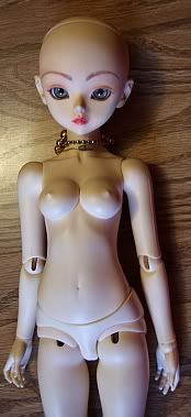

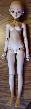

    15. ranmanekineko can you show us QiXa nude without wig? Just to see how is the scale of the joined parts.
      Can you take pics like this example?
      Sure it will help a lot to people who dreams with this doll but are not sure at all because the "problem" of scale ^^
    16. Ok- I hope these pics help you see the Ani head is not too big for a MNF body.
      QiXa was not happy about being nekkid on the table, but she knows this might help another Ani get a great body, so she did it. :)

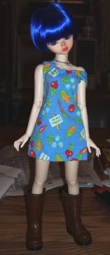

      But check this out. I received my CP MNF today from Luts. I'd ordered a Woori head because I plan to put the Woori head on the small-busted MNF body and sell the No. 7 head. I assUmed that the Woori head would fit, and Presto! my day would be complete.
      Wrong! The No. 7 head is equipped with that latching mechanism and the neck on the MNF body is too long and too wide. Here are pics to show what I mean:
      No. 7 head on MNF bod (looking good):
      Woori head on MNF bod (oh, no):
      Detail pics showing the differences in the neck sizes and neck openings:
      I presume that I have to make some mods, like sawing off part of the neck and creating more of a taper. --I've never done anything like that before. :nowords:
