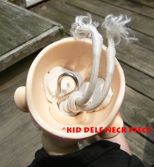

      Here you can see that her S-hook is held in place by the Kid Delf neck piece (which I could swear came with her head -- and she's an older head as well. Definitely verify with Luts that you're getting one with your Ani head, though!)

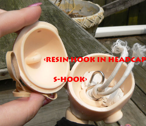

      Here is her headcap, showing the resin hook. You can attach the S-hook to this hook and skip out on the neck piece altogether, but since I like to change out Ivy's eyes frequently, using the neck piece works better for me.
