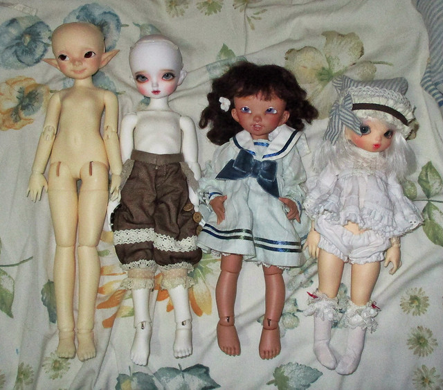

    5. Heres a couple of my LTF hybrids (far left and far right). Its kind of tricky but it can be done. I use the Fairyland headbacks and this is my process:
      Theres an extra connector piece thing that goes inbetween the neck and the head back. I take that thing out of there, and pull the string up through like normal. I also make a small notch in the resin so the hook will sit flat.
      LTF heads sit much lower on the neck when the connector piece is removed so you may need to put in a neck donut. I just use a little hot glue inside the neck because im lazy lol
      [​IMG] [​IMG]
    6. @Cydril wow cute dollies!
      Thanks for the tips, I think I know the piece you're talking about. I'll see what I can do once the body I ordered comes home.
