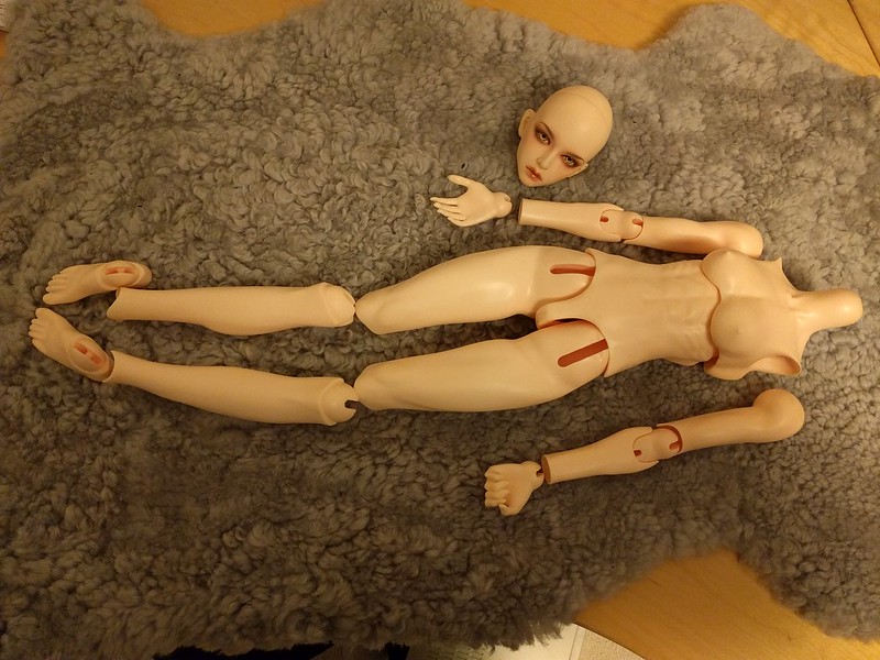

    14. Hello guys,
      she has arrived, this Monday to be exact, but at the moment she is in pieces as she was strung very weirdly upon arrival (legs very very loose and arms super tight) and I had to cut her arm cord to get her unstrung, she's very lovely though, the Vivien head is stunning and fits very well with the body proportions, but alas as @Rosslyn said she definitely needs some extra love and care (and sand paper) to become as good as she looks.
      The first step is to get new strings and s-hooks for her hands and feet and then sand paper for wet sanding her seams, wish me luck! :kitty1
