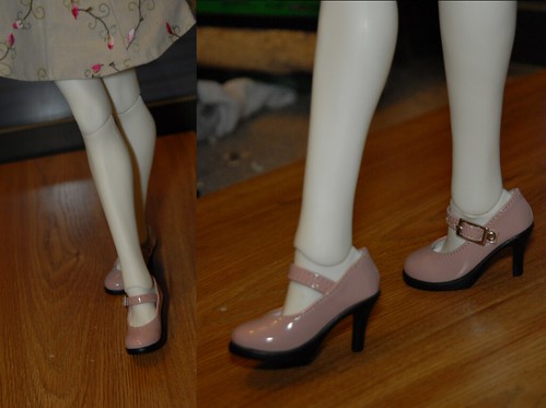

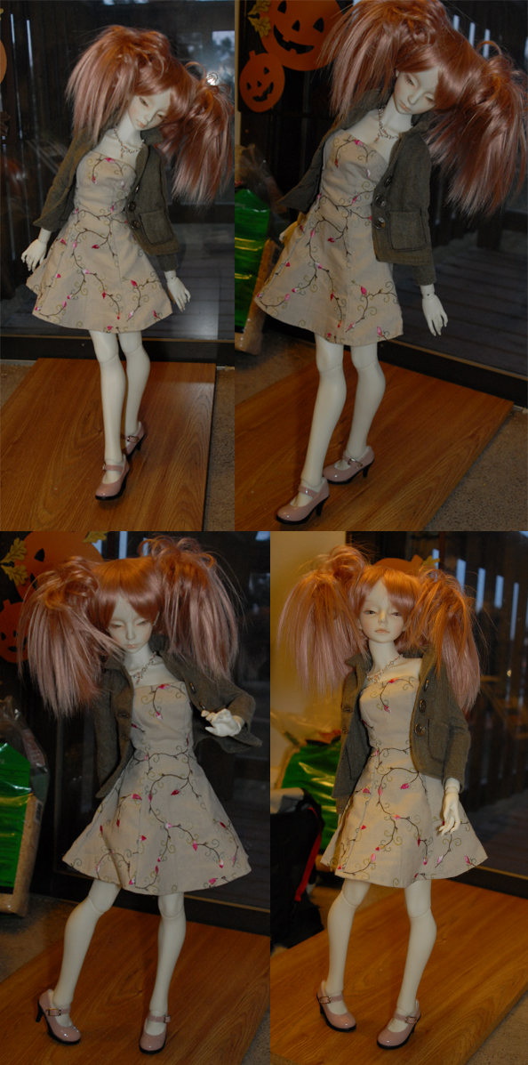

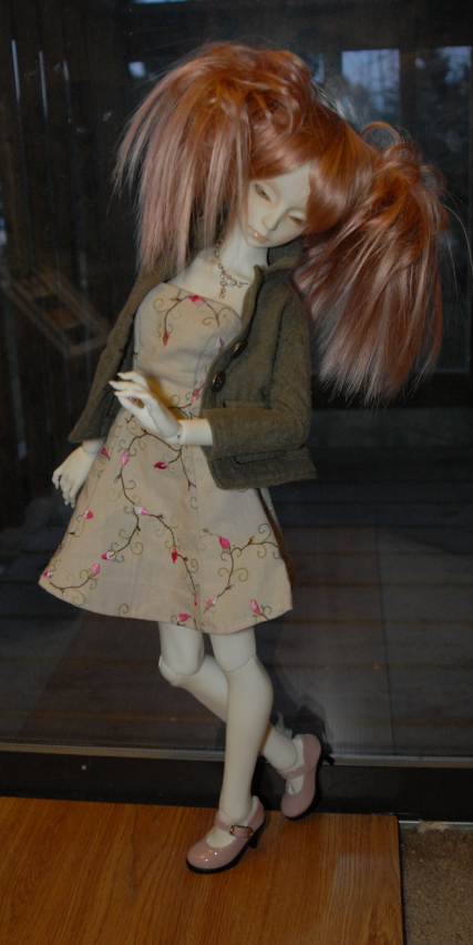

      First we have my white Limhwa body with Limhwa high heel feet. The shoes are Luts’ I believe they’re meant for Senior Delfs. Obviously the color matches since they came together, and incase it can be helpful the color is a perfect match to the Kdoll Karon head that she’s currently sporting and is also a match to the Luts Delf white from about 2 years ago. Its very white but a creamy white not paper white.
      As for balance and poseability, the ankles aren’t really designed with much mobility in mind, they move a touch front to back and not at all side to side which makes balance hard. The other issue that makes balance hard is that my doll is an unsueded Limhwa. She’s designed to stand with her feet like this X, and with no ankle motion that makes balance in any other pose realllly hard. Without suede and in her high heels she can’t stand with her feet side by side without being propped against something. She can stand though in a few poses, some with only the tip of her toe on the ground.
      My over all feelings are: They’re beautiful feet, sorry for no bare photos, the straps on the shoes are a pain, but the sculpting is wonderful. However the mobility prevents what could otherwise be some pretty stellar posing, so I think I may try my hand at some Supia feet.

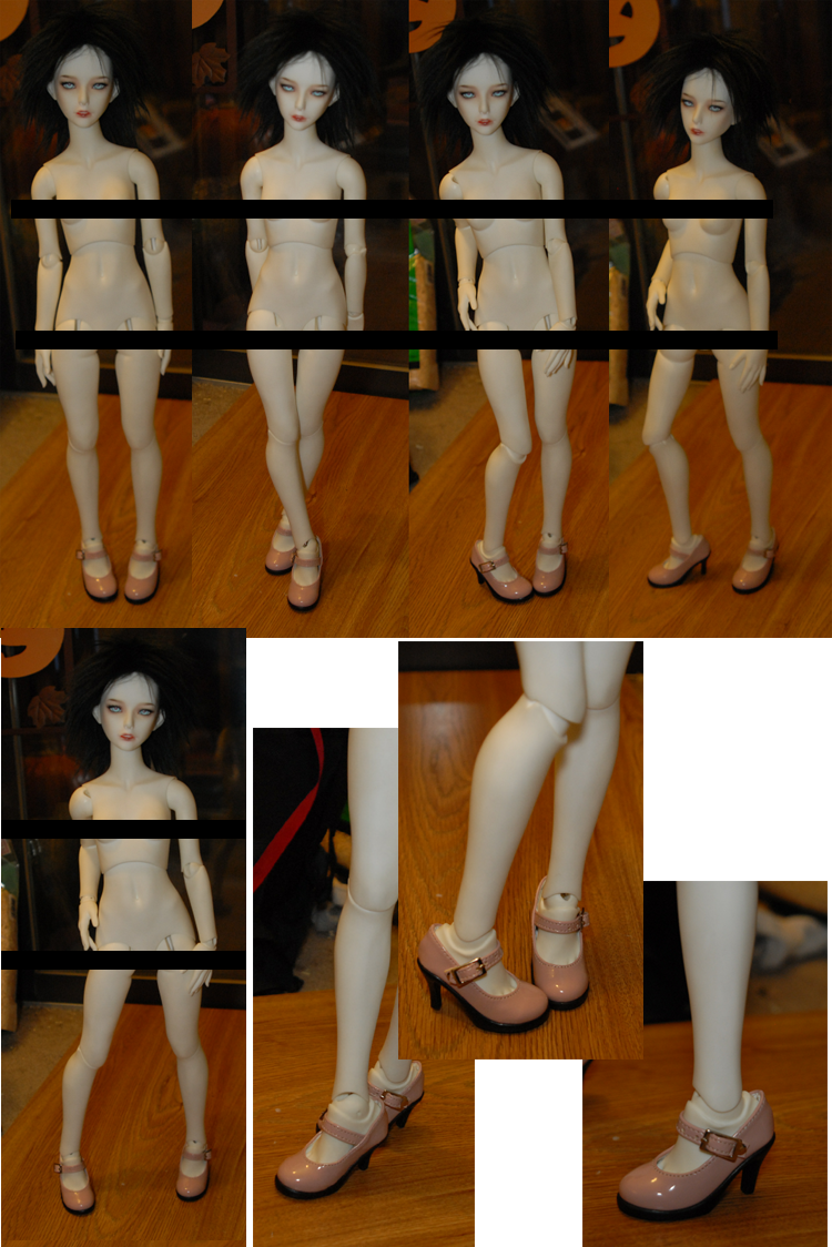

      Next we have a white Zaoll with the white Limhwa feet. Please forgive the nudity, she was chillin’ naked in a box and I was lazy. The color match is pretty good, my Zaoll is over a year old so she’s mellowed (and filthy) but when I got her she was seriously paper white, we’re talking so white her shadows came up with a blueish tint. But the Limhwa is only a few shades darker than her current color, which is an almost paper white. The difference is noticeable when you’re looking for it, but if you’re not they might as well be her original feet.
      As for posing, it’s MUCH better than the same feet on my limhwa. The ankle ball is a little too big for her ankle so when she’s not standing it’s a little rattly, but the mismatch gives free range of motion and allows her to do all kinds of nice poses, and she will stand if you simply set her down. The only thing I could see being a problem (aesthetically) is that her heel sticks out kind of far from her skinny ankle. Though Zaoll heels stick out a bit on their original feet too.
      Overall feelings: I think I’m about 97% satisfied with the match, the only issues are loose feet and narrow ankles, neither which affect her ability to stand, so…Woot.

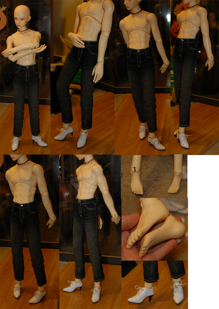

      And finally we have my poor Leeke Mihael on a Dollzone 65cm body with Dollzone heel feet, the shoes are Dollheart, SD13. Vanya, my most masculine male, would like to murder me for this but here we go anyway. First a quick mention on color, Leeke is a touch pinker than Dollzone yellow, but they do make a decent match with a tiny touch of blush. On to the feet…Dollzone has ugly, manly high heel feet, they’re pretty big and have man toes. They’re close to the same size as his normal feet but somehow look a little dainty on his manly body. The ankle ball is a touch smaller than his original feet but fits nicely and has a free range of movement.
      The posing is actually pretty good, I think it would be a lot better in higher heels and if his body itself wasn’t a snappy, finger pinching, double jointed b*tch. He can easily stand in all the poses shown, some need a little balancing on the ankle balls, but they were all 5 second or less efforts and once standing, he’s sturdy. The body/foot combo makes for great Louis the 14th kind of poses.
      Overall feelings: If I wanted a heel wearing man, I’d say pretty good, somewhere close to the goodness range of the Zaoll/Limhwa. They let him pose naturally, stand sturdily, and merge into his leg pretty nicely. Their main downfall, and maybe it’s just the shoes, but they like to lean so the side of the foot with the big toe is higher than the other, like he’s rocking on his feet. I think this would easily be fixed with a little glue suede in the ankles though.
