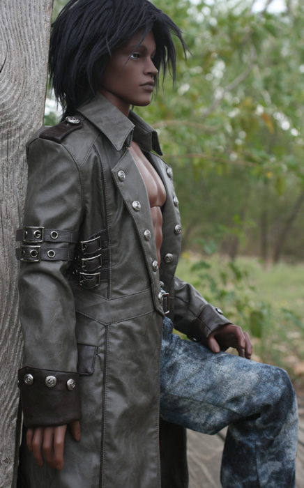

    5. One of the tricks I use, is just a touch of leaning against a nearby object. Usually a tree for me. You can balance the majority of the doll's weight through one leg, and have the other bent in a natural pose, while using the arm on the bent-leg side to finish out the balancing. I'm not on the computer with my photos, so apologies for no visuals here. :sweat
      Actually... here's one of leaning back:
      And then there's just flat out patience (and no wind!):
      It can be done, it just takes a bit of work.

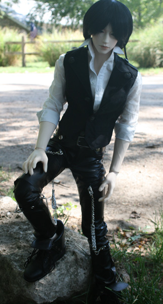

    7. First thing I do when I take them out of the box, is tighten their strings.
      No glue sueding or wiring or anything else though at work here. :)
      It just takes a lot of patience and a bit of practice to get them to behave. I think it took me a good five to ten minutes to get Quang to stand with his leg up on that stone.

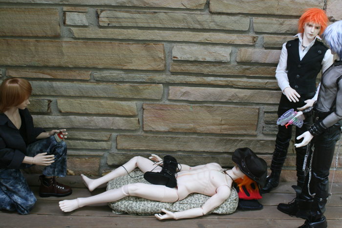

      This is from a little while ago. Malak is the one kneeling. It took a while to get him to kneel (he's not leaning against anything), and then more time to get him to hold the camera just right, but it can be done. (These are all model body (and all Chases).) I think I did use a knee-wedge (camera lens cap) to keep that right leg from collapsing entirely, but that's because I had to do so much fiddling around with his arms and hands for the camera. Again, another ten to fifteen minutes this time, getting him to balance just right.
      Kurosaki: That's not soda again, is it? It took forever to get that off him last time.
      Shirosaki: He'll be glad I couldn't find an air horn.
      Malak: Okay, camera's ready when you are!
      I love these guys, and while you can't make pretzels out of them, they do fairly well. Paku, the naked one there, is the only one with the mobility thigh. I haven't really had a need for it.
