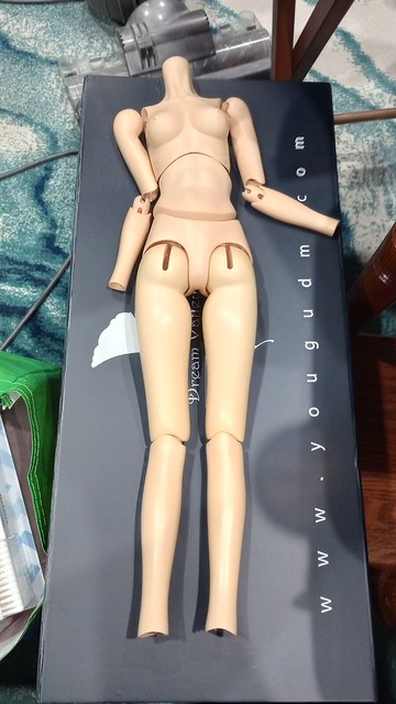

    8. My dolls have made me bleed several times, but my biggest restringing fails are always due to my cats. Learned this the hard way restringing an Angel of Dream 1/3 female body.
      Step 1: carefully lay out parts for dry fit before restring:

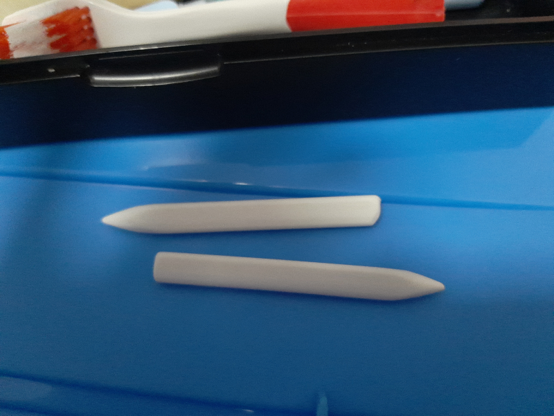

    11. My Maskcat has that nice system for swapping hands, but her feet have just an s-hook. I have made these things from a piece of white plastic:
      I just sanded them into a blunt tip.
      I pull the foot with one hand and I hold the leg with my other hand, while also keeping one of these between my fingers, and when the cord is out I stick it in. They are shorter than, say, a pencil so they're easy to handle, but long enough that they won't slip once they're in.
