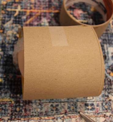

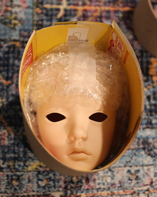

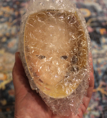

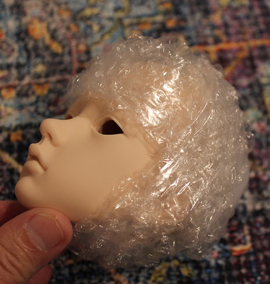

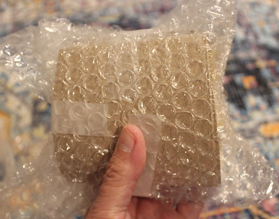

    3. Personally tissue paper can shift on face. I do what I would do if I was going to do a shield. I do a head band of bubble wrap and a chin to top of head band of bubble wrap and then a circle of cardboard and then bubble wrap helmet.
      [​IMG]Head-wrap-23 by Marie, on Flickr
      [​IMG]Head-wrap-24 by Marie, on Flickr
      [​IMG]Head-wrap-25 by Marie, on Flickr
      [​IMG]Head-wrap-26 by Marie, on Flickr
      [​IMG]Head-wrap-27 by Marie, on Flickr
      You can't use to much tape and if head is on body you can go thinner on cardboard around chin area. I felt rushed but I can say this does work well.
