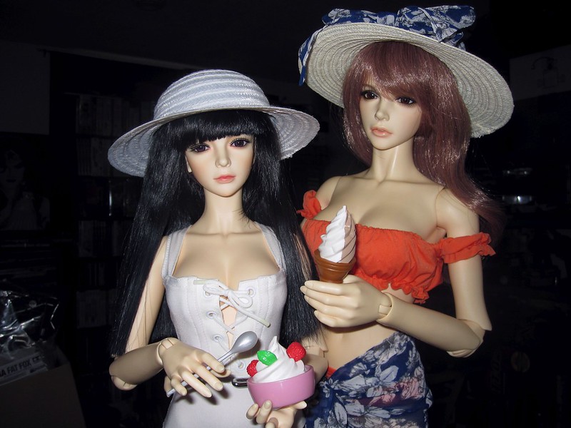

    12. Silicone earplugs like Mack's earplugs are my go-to for this sort of thing. You can tear off a small portion and make it easy to hide the silicone for photos. Check out my Iplehouse nYID Olivia holding the spoon in particular.
    13. Oh wow, that appears to work really well.
