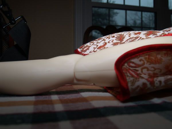

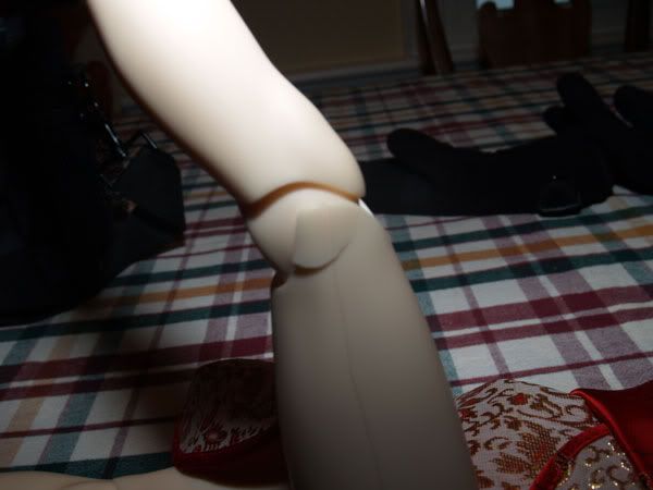

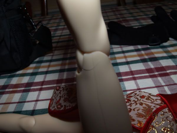

    20. Here are some pictures of the break:
      Laying down. The break is not as visible in this position, however.....
      When the knee is even a little bit bent, the piece sticks out drastically. I didn't bend her knee any farther than that, for fear of breaking the piece off completely!
      Another view of the break when the leg is straight.
      I am not going to glue it back just yet. First I will email Volks and see what can be done about it. Even though I didn't buy her directly from them, it's worth a shot to ask them.
      I advise anyone who this has happened to, to email Volks about it. Also, if your doll is currently broken, do not fix the part until you sort things out with Volks! Keep the doll exactly as it was when you found the break(so as not to contaminate the evidence :wink ). If you fix the break, they may not give you a replacement(because it wouldn't be broken anymore if you fix it!).
