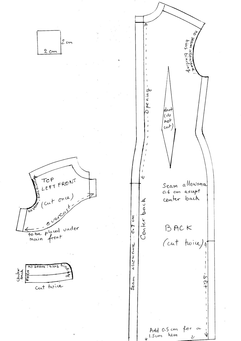

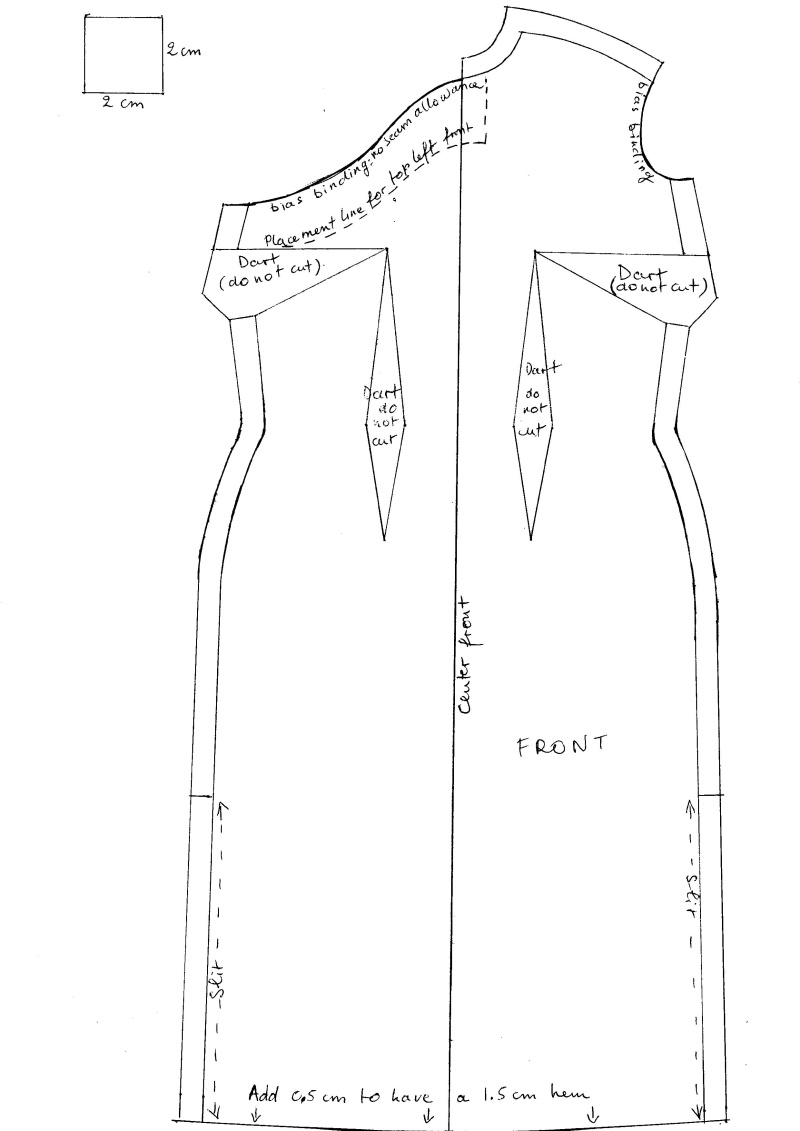

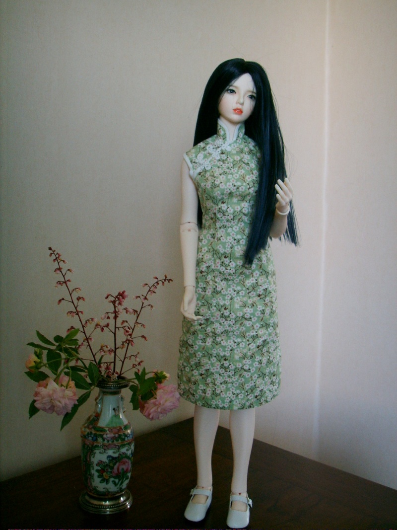

This thread is a great help and I'll contribute whenever possible. To start with, here is the qipao pattern, which you can access following these links : PDF Host PDF Host Please note that this qipao opens at the back and the pattern is for a slim body, small bust. Here are the main steps : 1) Bias bind raw edge on the front bodice, following the red line. If using buttons and loops instead of frog closures, now is the time to place them (under the bias). Sew on the line where the bias meets the fabric. 2) join the shoulders and sew the darts. 3) Collar. The fold is the center back. Bias bind, following the red line. Sew collar on neck line, using a bias inside to maintain it and hide the seam. 4) Armholes can be bias bound now, or after having sewn the sides together (smarter, but more difficult). 5) Back : join the two parts from the bottom up to the opening mark and place a zipper (I used an "invisible" one, the pull of which I removed and replaced by a bit of string) and eventually a hook and eye on the neck line. 6) Sew the sides between the slits and the armholes. Bind slits, or just fold the seams inside and use a welt cord along them. Hem the bottom. Sew frog closures. N.B. There are tutos on the web to learn how to make frog closures, chinese knots, bound slits, etc. I 'd be happy to see the qipaos you will make in your turn ... Enjoy !

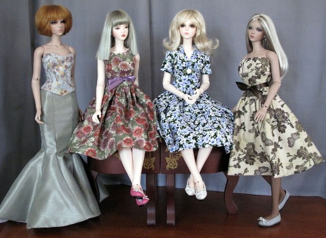

I finally took a photo of my girls wearing various fashions I sewed from the patterns mentioned above in post #3. From left to right: Lucy is wearing the Night at the Opera skirt (lengthened through the thighs) with Gracefaerie's #21 Corset. I don't remember what adjustments I made to the corset, except that I used the solid front version that laces up the back. Her wig is a mislabeled FairyLand 6-7, supposedly for LittleFee but much smaller in reality. Mika is wearing the EGL dress from Gracefaerie's #14 Mini Wardrobe for Narae. I omitted the sleeves and any hint of frills or lace. The waist could be a wee bit longer. Her wig is Yuri from Monique Gold. Sarah is wearing the Dressing Up for Nancy and Hermione. I sewed this in a quilter's weight cotton and don't remember making any adjustments to it. @Robyn_in_WA also made this dress but in a lighter weight fabric and had fit issues. Sarah's wig is Shaine from Monique Gold. Finally, Gene is wearing Hollywood Ahoy in a quilter's weight cotton. I had a lot of fit issues with this one, which may be due to my choice of fabric. The top part of the bodice needs to be gathered, but my fabric was too thick to work so I pleated it lightly and removed excess fabric. Gene's wig is Paris from Monique Gold. A note about the shoes: I found flats that fit! I bought them for my Unoa Chibi, but found they were a bit narrow for her. Happily, narrow on a Chibi turned out to be perfect on a Raccoon girl. (Gene is wearing stockings but Mika and Sarah are not.) The shoes are Bows by DollinStyle. They measure 54mm by 20mm. Denver Doll has only 3 colors left--I'm kicking myself that I didn't buy the others when they still had them. I'm afraid that DDE won't or can't restock, as the two styles that fit Minifee are all but gone and have been for quite a while. I haven't found any other shop that sells them. @Naïka - Thanks for posting the qipao pattern. I haven't downloaded it yet. The host wants to place a tab on my computer and I'm still thinking about whether or not I want to allow that.

@ vermont chick. You are welcome ... From what I could see in this thread you are a good seamstress, but if you happen to have a question about this pattern or my explanations, please don't hesitate to ask, you and anybody who wants to try it. As it is, my "red lines" don't show, for some reason, but I think one can work out where they are since they are the bias binded bits.
Naika sent me the file in two formats. The red lines are the edges that are bias bound with no seam allowance. The images above work fine. For those on Windows, right click on an image and save the image. Whatever program you use to print it, you must choose exact size or 100% scaling. The pattern is on A4 paper, so use legal size paper if you don't have A4. I will work on creating pdf's.
