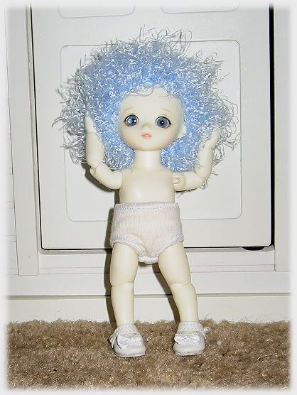

    5. I thought you might like to see the wig I crocheted for my Pocket Fairy Poppy. I'll be glad to share the pattern if anyone is interested.
    6. That's cute! What kind of thread did you use?? Was it hard to work with??
      ~Sealpup
    7. I used Paton's Cha-Cha yarn and an F hook. Initially it was a bit awkward, but once I got going, it was ok..I just had to keep pushing the fuzzy bits to the back of the work so the rightside was smooth, and all the fuzzy part was on the wrong side. It only took about a half hour to make up.

    9. Thank you for the tip ~ I'll have to try that! If you make anymore cute things, please share pics with us!

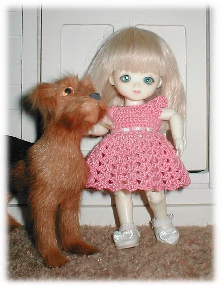

    11. Here is a little dress I crocheted for my Pocket Fairy a couple weeks ago.

    13. That's so sweet! I'd love to try it!

    15. Wow Labrat, your crocheting is lovely!! What size thread did you use?

    16. Here is the pattern for the crocheted wig I made for my pocket fairy:
      Paton’s Cha-Cha yarn
      size F crochet hook
      Round 1: ch 4, join to make a ring. 8 sc in ring (pushing the fuzzy bits on the yarn away
      from you) Join to first sc.
      Round 2: ch1, mark stitch and make 2 sc in ea st around. Join to first sc. (16 sts)
      Round 3: ch 1, mark st and do 1 sc in same sp as joining, *1 sc in next st*, 2 sc in next
      st* repeat from * to* around, join. (24 sts)
      Round 4-10: work even on 24 sc, continue pushing fuzzy bits on yarn away from you as
      you work.
      You may need to do less or more rows depending on how it fits.
      End off and run in thread ends. Turn inside out so the fuzzy bits are on the outside.
    17. [​IMG]
      Crocheted dress for Pocket Fairy
      size 20 crochet thread (I used Cebelia)
      size 10 steel hook
      Note:
      V st=dc, ch 2 dc in same st.
      shell= 2 dc, ch 2, 2 dc in same space
      Row 1: ch 23, sc in ea st across DO NOT ch 1 at end of rows to turn)
      Row 2: 2 sc in ea st across (44 sc)
      Row 3: sc in ea st across
      Row 4: sc in first 7 sc, ch 4, skip 8 sts, sc in 14 st, ch 4, skip 8 sts, sc in last 7 sts
      Row 5: sc in ea sc and ea ch across (36 sc)
      Row 6-7: sc in ea st across. at end of row 7, ch 4 and turn
      Row 8: (beading row for waist) sk first st, dc in next st,* ch 1, sk1 st, dc in next st*
      repeat from * to * across (18 dc, 1 ch 4 post)
      Skirt:
      Row 9: ch4, V st of (dc, ch2 dc) in next dc post and in each post across, end dc in last
      post .
      Row 10: ch 3, shell of 2 dc, ch2, 2dc in ch 2 sp of first V st, *V st in next v st, shell in
      next ch 2 sp*, repeat from * to * across, ending dc in last dc post, ch 2 and join
      to first ch 3 of row with a sl st.
      Now working in rounds without turning:
      Round 11-15: sl st to first ch 2 sp, ch 3 dc, ch 2 2 dc in first sp, then shell in each ch 2 sp
      around. End off and run in thread ends.
      Shoulder ruffles: With rt side facing you, attach thread to last underarm st of bodice,
      shell in next st, sk 2 sts, shell in next st until you have 4 shells, sl st in first underarm st and end off . End off and run in thread ends.
      Finishing: attach thread at beading row with a sl st and do 2 sc in beading row, sc in ea
      st up back to 2nd row of bodice, ch 5, sc in first st of neckline and slip st across
      neck, and sc in ea st back down to beading row, 2 sc in beading row, sl st in
      next st and end off. run in thread ends.
      Run silk ribbon through beading row and tie in a bow in the back.
      Sew a tiny button opposite the thread look at the neck to fasten top.
    18. I can't take credit for the beautiful little knitted dress. My friend, Vicki, made that for my Baby Fairy, Mies. I can knit, but not very well. I couldn't make something that nice. My forte is crochet.
