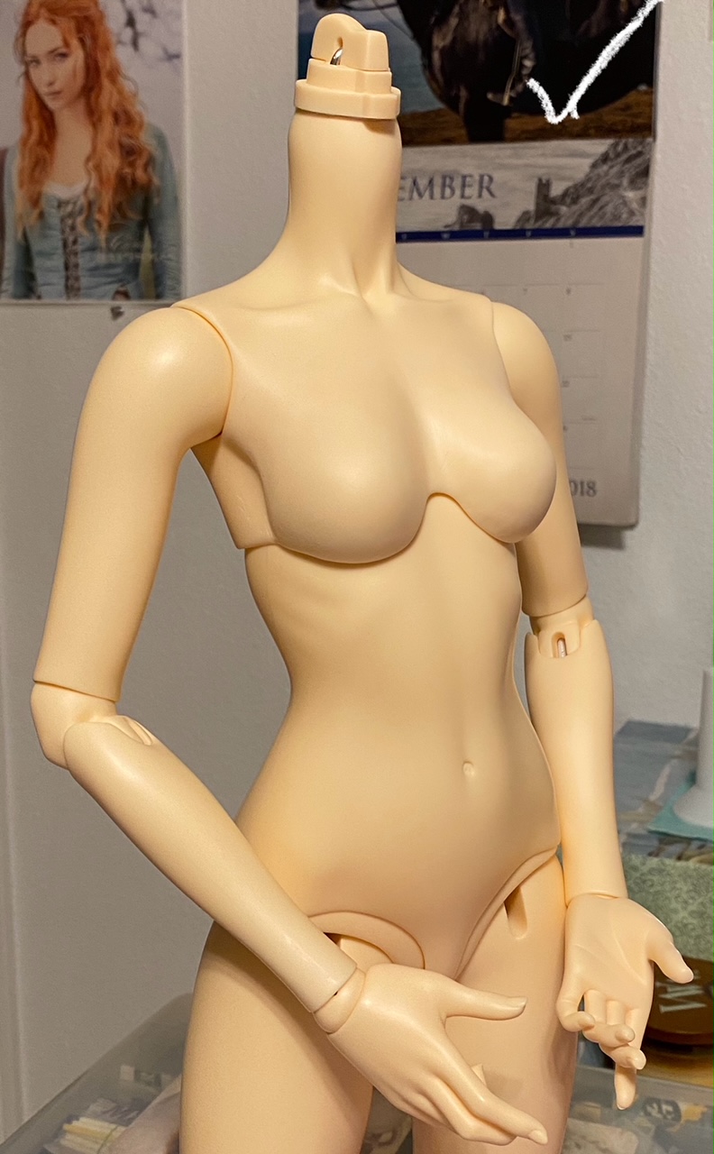

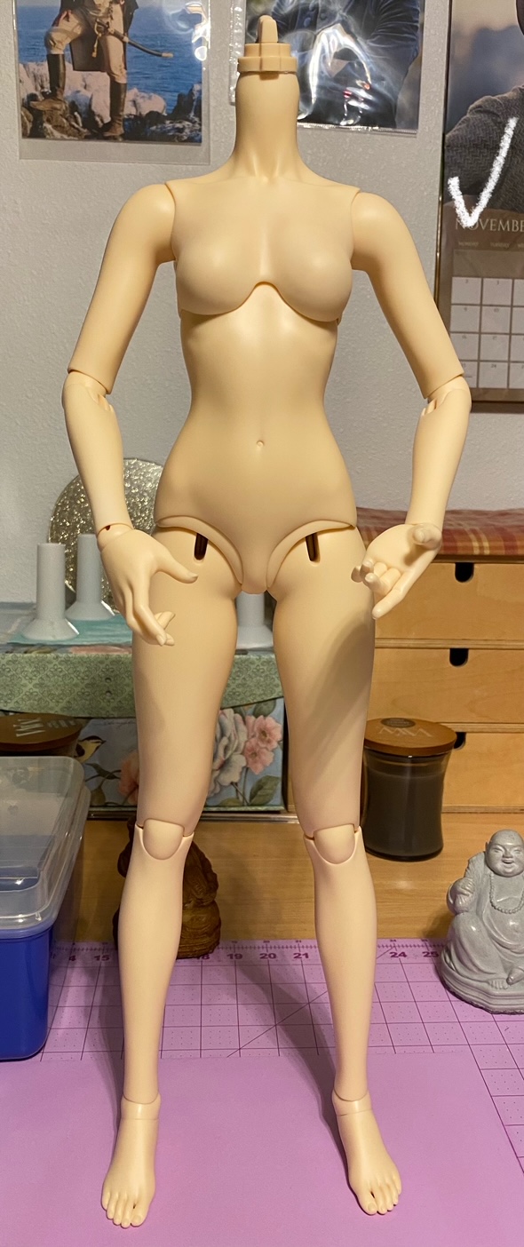

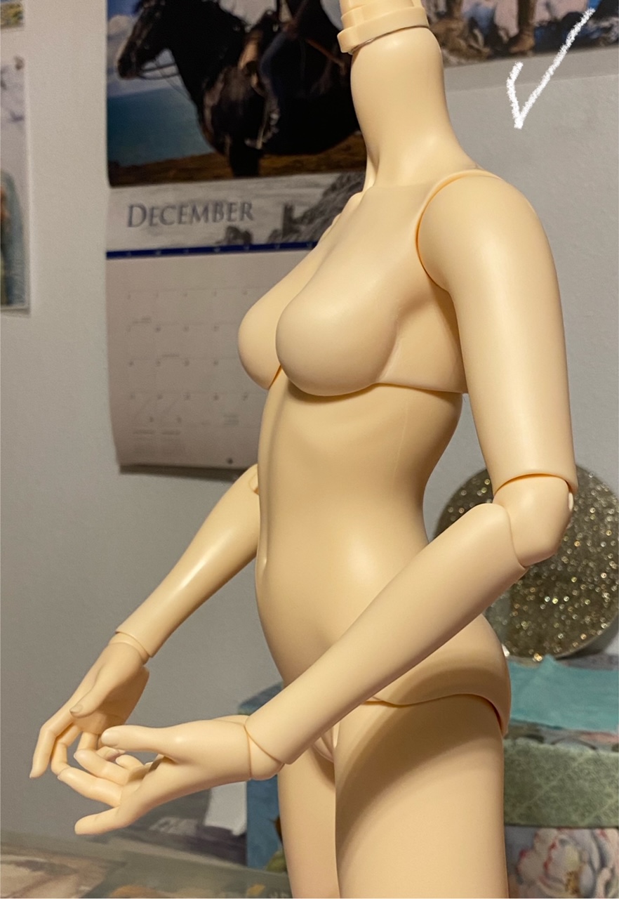

    10. My new F65 Angela2 head is away being painted now, but I wanted to share a
      major mod that I’ve completed on the body. I’ve loved the handling and posing
      of the Feeple65 body for a long time, but just did not care for the huge bust.
      I’d emailed Fairyland 15+ years back asking for a small bust option (which they
      said at the time they were working on). So having had a wild hair, I ordered
      another Angela2 to try a bust reduction. In the end it took two periods of
      working on it to get it to where I wanted.
      I hope that no one is offended by the headless body pix.
      I will share more pix when her painted head returns, but in the meantime -
      I made a thread in the workshop if anyone wishes to see more photos - I included
      some “step 1” photos in that threads and the mods I did to her faceplate
      https://denofangels.com/threads/feeple65f-bust-reduction.876677/#post-13159066
      #350 Robyn_in_WA, Jan 21, 2024
      • x 13
    11. Nicely done.
    12. Wow that must have been quite a task! I really like it and agree...I'd love to see a smaller bust option! You did a fantastic job - I can't wait to see her when she is all complete again.
    13. Oh wow, that turned out really good! Very natural shape. Great job with the reduction!
    14. @Robyn_in_WA So super cool! Wow, you'll probably have an easier time fitting her into tops and dresses lol. Can't wait to see how the faceup comes out!!
    15. Thanks @Tippetarius !
      Thanks so much @LyanneNZ !!! It really was quite the job. Once I thought I was
      done, I looked at her more after reassembling, and then decided it wasn’t good enough
      and took her apart again for more work. I’m very glad that I did. I can’t wait to see
      the head when it returns too - she’s being painted now.
      Thanks lots @Yuns !! The natural shape was absolutely what I was going after!
      Thanks so much @Ctrowbridge77 !!! She can definitely wear shapely dresses now
      and slip into the medieval gowns that I so enjoy making! Me too - can’t wait to have
      her painted head back! I asked for a natural, elegant look for her painting.
