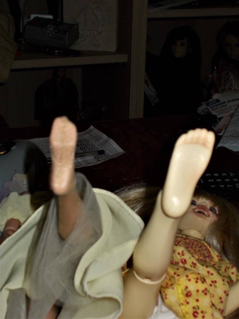

    7. I have Tonners and I have Unoa Chibi, here's a comparison shot of their feet:
      Other shots here:
      16" Tonner and Unoa Chibi foot comparison
      16" Tonner and Unoa Chibi foot comparison (bit blurry but shows the sizes)
      The Chibi can wear shoes for the Tonner male dolls (who have bigger feet than the female fashion dolls) and the larger flat-foot Tonners female Tonner's such as Herminone and Nancy Drew, but not the regular 16" Tyler Wentworth sizes that have so many attractive high-heeled shoes.
      I dont think the regular Unoa feet are smaller than the Unoa Chibi feet as some sellers offer shoes that fit both. But I don't have a doll with that size feet to compare with,.
      Good luck with the foot hunt. I just didn;t want to let you make a decision thinking your doll would be able to wear all those gorgeous Tonner heels and then be disappointed.
      Teddy
