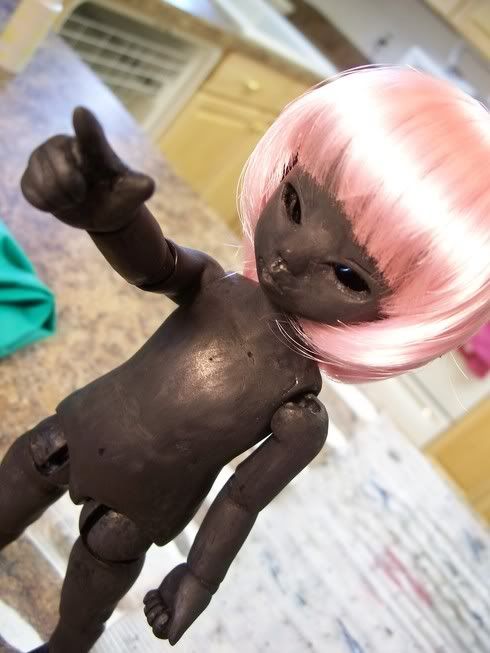

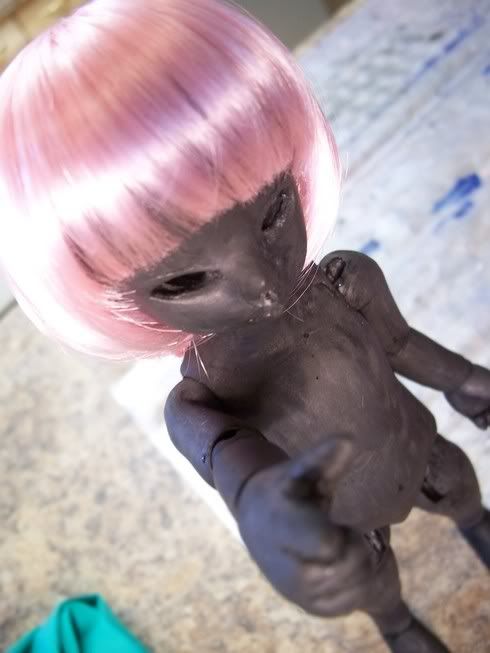

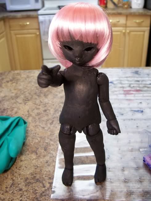

    6. :...( Sad news everyone...after some severe attempts and not only covering the inside of my bathtub a funny blackish blue color...and staining my hands one sickly color I've come to the conclusion that I will not be able to sell any Black or Dark Blue dolls at this time...
      I'm contacting Enki to see if she may be able to get some Rit Dye and airbrush it on with her airbrush machine.
      ..as the Alumilite Dye I have only works and stays on when you mix with the Resin...I was able to almost successfully dye the doll...but with a pretty major problem....black or blue residue comes off on your hands...it will stain any wigs or clothes that you place on it...it will also stain any acrylic eyes placed in the head :( I'm very overly beyond saddened by this.
      I do not Own an Airbrush machine...nor can I afford to go run out and buy one...so I have to for this instant take Black and Dark Blue off this preorder...I will offer full refunds to those who do not wish to change there Current Color ...I will also extend the offer of having a light Yellow or light/medium pink Ted...these are not colors I was originally planning to add to the Preorder but due to the recent attempts and the fact that I don't have an airbrush machine... I have to make this call...I've waisted a full day and 1/2 of work trying to save these two dolls and these two colors...but with my current supplies, I can not.
      I'm so very very sorry to have to pull these colors from the Preorder till further notice....
      If Enki is able to save the Black and Dark Blue Dolls with using Rit Dye and her airbrush Machine...than I will re-instate these colors to the preorder...I'll be calling her Today to see if there is anything she can do and if she's able to help me with this....
      again I'm so very sorry.... I will be casting a Full Light Yellow and a Full Pink Ted between Tonight and tomorrow...so if you were originally in this preorder for a Black Or Blue Ted Please contact me so we can discuss a Change in color....
      here are Pics of the Black Ted: :( (As I was stringing him up...my fingers turned a funky charcoal Grey...and the stringing within him is also a funky grey O.O )
      Saddest of all is me...as I was really falling for the idea of a Black Kitty Ted :...(
      The color looks pretty good...it's just it has a black residue that comes off on anything it touches...

      ^^; if you guys remember the pic I put up with a bunch of doll parts in separate zip lock bags... there was a black on in the pic...and the black looked totally fine...nothing came off of the doll...the dye was all the way through...it's only when I did the clean up work and sanded down the doll...there was a slight color change...very noticable...everywhere I had sanded had turned Grey black...and what I hadn't sanded was still jet black...so I tried re-dying the Doll...soaking for a whole day randomly checking on it to see if it was jet black again...and when it finally was jet black all around again...I tried soaking it in warm water...and cleaning it...tons of black came off...but the doll was still pretty solid black looking...but there was a residue that was coming off of the doll...but the color still looked like it was remaining on the doll...I sprayed the doll with msc...this turned the whole doll a charcoal black color...so I was unhappy again...so I re-dyed it again... and hence started the whole problem over again ^^; ....but I used the Alumilite dye not Rit Dye...and apparently you are only suppose to mix the alumilite dye with the Resin...not after the resin's been cast and solidified ^^; this was my mistake...but I've talked with Enki and she is going to use her airbrush machine and Rit Dye...so the dye will not have any odd residue that comes off on your fingers ^^; like the alumilite dye
      I did that ^^; it's just that I sanded down quite a few parts on those dolls to fix them up and make them look clean and they changed colors where I had sanded them ...so I tried re-dying them...it worked ...but at a cost ^^; but yeps...commisioned Angie-kins (Enki) to save these two adorable colors with Rit Dye and her airbrush machine ^_^
      ^_^ Yeps hopefully Enki can work her magical Airbrushing skills and with Rit Dye Fix them ^_^
      ^_^ *Huggles* I'm going to send him to Enki...to have her work her Airbrushing magic with some Rit Dye and have her try and save these two colors ^_^ ...which this should take care of his residue issues...this particular one...I'm not too sure of...but I'll be sending all dark colors to Enki to re Dye with Rit Dye and her airbrush machine...I sadly enough do not have an airbrush machine so I can not do what she can do...
      ^^; Yeah I did mix the dye in with the resin as I mixed it...the problem came after I sanded the dolls...then there was a noticable color difference...I have not had this problem with the normal skin (Dark or Light) or the white...but the Black and Blue...there was definitely a problem ^^;
