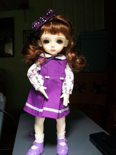

      Here's a pic of the new version body. The mold is Momo, her name is Anya.
      Anya by saabira, on Flickr

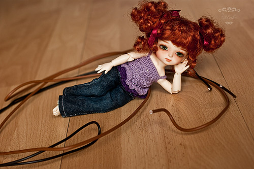

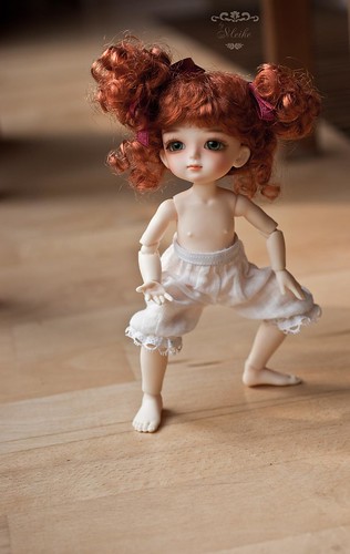

    9. An update on my 'how to get Abby to pose better' efforts! Got rid of the pipe cleaners, because once I tried real wire, WOW, what a difference!! I am not sure of the official term for the wire I used, I think they called it construction wire, or installation wire, or some such! Mine is black (they didn't have any other colours unfortunately) and 1.5 mm, and it worked wonders!! See:
      SO much better! I also hot glue sueded her arm sockets and elbows. I can finally play with my girl without getting frustrated by her inability to hold a pose! :D

      EDIT: quick pic of the wire I've been using:
      It's rather stiff copper wire coated in plastic.
      I used the black for Abby; it's 1.5 mm I think.
