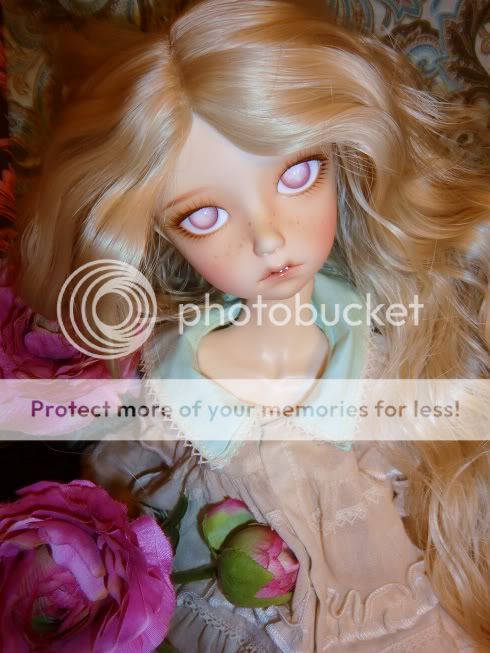

    13. Yay! My new Monika arrived today and I am simply In Love with her :aheartbea
      I really like the Soom default eyes -- they're a soft eye and don't have that 'hollow' look that some pupil-less glass eyes give -- so it's more of a sweet-look as opposed to I-want-to-suck-out-your-brains-look ;P
      And, as others stated, the default wig is nice and full ... and heavy!
      Forget about worrying if she can sit (she's propped in the photo) -- she was shipped loose like everyone said and I've never re-strung a doll (I don't feel like tackling it right now) so she's staying 'as is' -- my girls mostly sit for photo shoots, anyway :D
