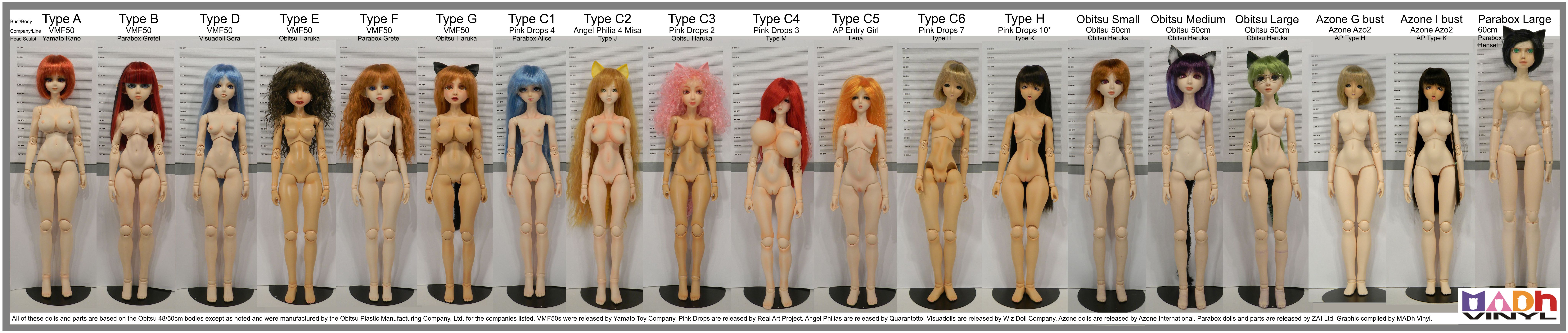

    10. I have a few APs
      The full size version of this image can be found here.
      You may find this image useful for comparing the various AP and other similar bodies.
      This image is a little out of date as there are now several more Type H busts/bodies. The Soft Skin models have the same appearance as their normal vinyl counterparts.
      A bit of history of the evolution to the current AP can be found here:
      Dollfie Dreams • View topic - VMF50 & Angel Philia Discussion Thread (nsfw, doll nudity)
      If you need images of AP models, I would refer you to my ongoing photo story MADh Vinyl, which by episode 180, 75% of the cast are AP and other similar Obitsu 50cms.

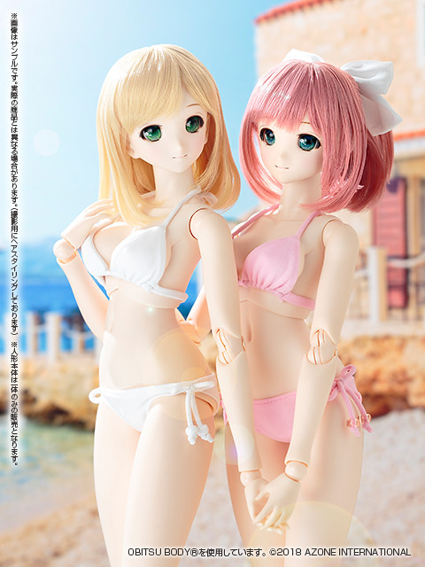

    15. Those girls are so cute! I’m a fan, even after just discovering them. I really like the one in pink.
