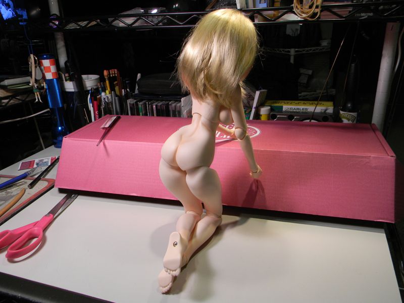

      Just about all of the 40-50cm busts/abdomens are interchangeable on those bodies as are many of the other parts. Since all these bodies (40cm-50cm) use the same basic interior framework the parts are all about the same diameter. You can get into issues with the tops of 50cm abdomen parts being too long on the smaller bodies but those can be trimmed down to fit. Arms and legs can be different lengths but can be swapped wholesale. Hands and feet are all the same. Heads are all interchangeable, it's just a matter of your personal taste as to whether a certain head works with a certain size body.

      Over the years other doll producers start using the Obitsu 48/50cm body. Yamato, Angel Philia, Parabox, Visuadoll, RAP, and Azone all have their own exclusive vinyl designs using the Obitsu 48cm and 50cm bodies, still all manufactured by Obitsu.
      It should be kept in mind that most of these bodies, variant busts, torsos, and heads are compatible with each other.
