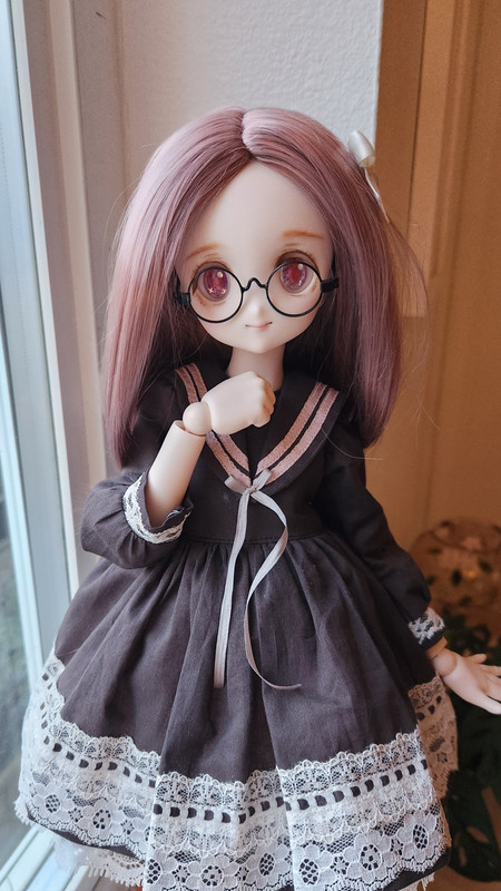

      I just bought an MDD secondhand at a con. I am pretty sure her head is DDH-22 (seller wasn't sure of the sculpt, but thought it was a newer one, and said she had bought her on Y!J) and she's on a MDD Mochi Ashi body. despite the fact that I already own a DDS and an MDD, I've never attempted to swap their heads around, and I always assumed all of the DD bodies and heads had the same neck circumference... I always see it advised that DD heads work fine with MDD bodies, and the neck size difference is put simply a visual/aesthetic issue that some may not like. buuut my new girl has an absolute bobble head, because her neck hole is bigger than the MDD neck, it doesn't have any friction and just wobbles around. The seller suggested using eye putty to keep it from wobbling, which has helped, but I want a more permanent solution. The putty slides around when I pose her head, meaning I have to adjust it to keep it where it needs to be. It's just frustrating. may be worth mentioning that the body overall seems a bit loose, especially the arms/shoulders, so that could be part of the issue... I haven't personally tightened a DD body before but I might need to start with her. anyway, has anyone else had this neck issue, and if so, what have you done to fix it? thank you in advance!!
    5. @TheBodyVolcanic I've not had much trouble with this except when my MDD was wearing a really long/heavy wig. In those cases, I use a small binder clip on the head post to help stabilize the head. You could also try swapping the head post with a third party option, there are some metal or 3D printed parts that are slightly larger.
      If the body is one of the newer 2.0 types and has a more narrow head post, Volks sells O-rings you can add to the neck for stabilization.
    6. Ah thank you so much! Yeah, I'm not sure why it's so pronounced, but it may be because the body is newer? I'll look into the o-rings, I had thought there was some kind of piece like that that they sold but I wasn't sure what it was called
    7. I ordered a set of the O-rings for DD from Volks and am now using a combo of three of those + a silicone kip joint to improve my MDD's head stability! it's not perfect, but MUCH better, and no more messy putty. here is a picture of her for tax :cheer
      (PS bear with me if the image is broken at first... trying a new image host, so I may need to edit the URL
      PSS... I think I got it:XD:)
      • x 8

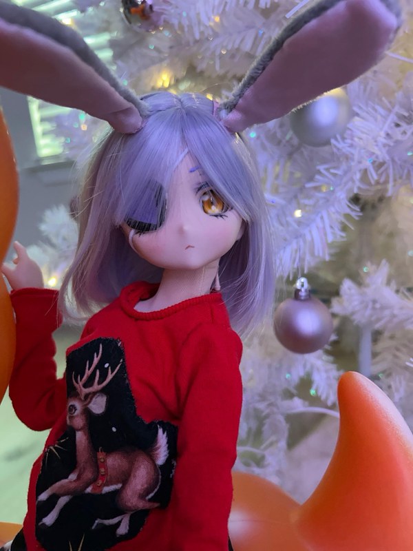

    17. Inspired by both existing DDs I've seen of characters and the Kotobukiya statues, I'm doing a Transformer-as-cute girl (Shockwave). Already been thinking about how to do the eyepatch without risking staining; definitely lining it in white and then either tacking it on directly with putty or using white elastic. For themed clothes, I already have Spoonflower plans. The G1-style box background pattern looks fun to incorporate into clothing.
    18. I finally ordered the new 2.0 mochi ashi body for my girl! super stoked since she on the original mochi ashi body and as much as i love her chunky legs the hips being so narrow made it really annoying to make clothing for her so I never actually got around to anything other than a few dresses :/
    19. Realized that I haven't posted any pics of my girl since I posted about ordering her. So here's Shockwave in her Christmas outfit.
      [​IMG]c1 by Cryptic Cryptid, on Flickr
