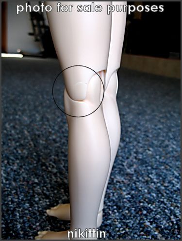

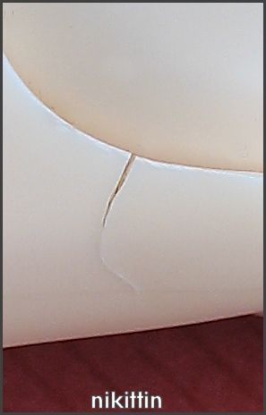

    6. Hi folks,
      Great news!!
      Just got back from Volks in Torrance and I was able to get a replacement thigh for my Magical Michael. Photos of his damage here and here (please ignore the "for sale purposes" :P).
      I explained to the manager that I purchased Michael at the store opening last November and since discovered the damage on his left leg. He charged me $39 for the replacement part. He kindly installed the new thigh also ^^
      I asked him what others should do that have experienced this sort of cracking/fracture on their dolls. He advised me to tell you to email VolksUSA and explain your situation. What they will probably ask you to do is mail the broken part to them (if you cannot come in person) and they will arrange to get a replacement part for you. This is how I understood it anyway :sweat
      Good luck to you all ~ there is hope!!
    7. I sent an email to their address explaining the issue. Lets see what happens...
      **EDIT**
      after sending in pictures of the broken part, volks agreed to replace the broken leg piece for about $39 plus shipping after I send them the part I have. :)
