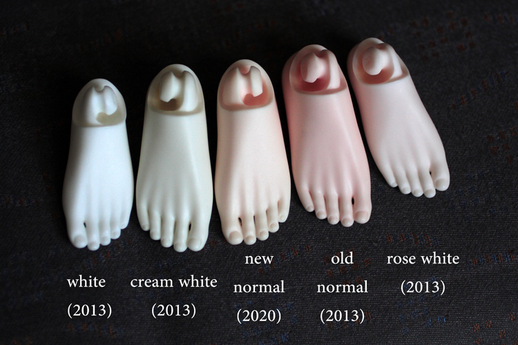

      Oh right, I also received samples of the new skintones with my new head and took a few photos. Gonna try and see about a better comparison later this spring when I get another tan doll:
      https://dimensiondolls.com/misc/withdoll_colors2020_02.jpg
      https://dimensiondolls.com/misc/withdoll_colors2020_03.jpg
      Worth noting that the 2013 samples are pretty old and though they've been stored in the dark all this time, they will have yellowed. But I was really pleased to see that the new normal skin is pretty much a match with bimong oriental skin and suits many of my older normal skin dolls very well too. :3 As I personally prefer a creamier tone since they will have the least change over the years as they yellow. <3 Whereas red-toned colors lose the red pigments pretty fast and have a more drastic change overall.

      Thank you for the photos of skin color samples. My older normal dolls pretty much match the new normal. It's easy to forget how much pinker they were when they were new.

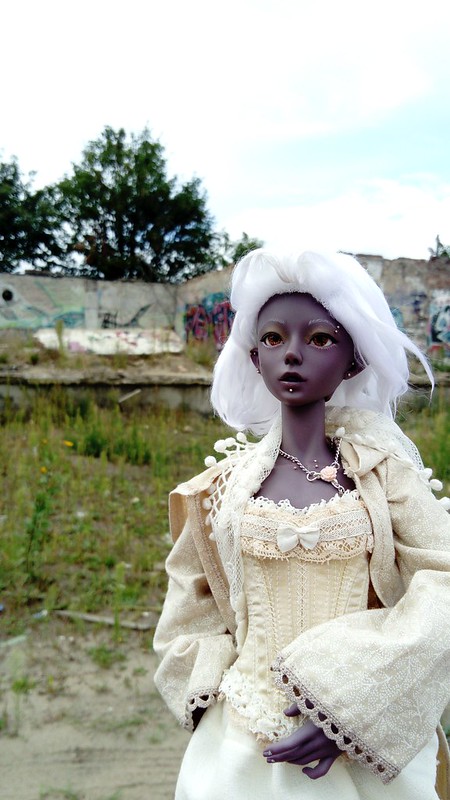

    10. Hi, I just got an old Nana and I love her! She has found her style and I didn't have to change her faceup at all.
      She is wearing a wig I had to sew smaller to fit better, SOULinaBOX eyes and her outfit was made by me yesterday.
      She is still a great shade of gray and her boyfriend is very happy she is home.
      [​IMG]Noori's warm woolies by SteamWitch, on Flickr
      More photos of her and her boyfriend on my Flickr.
